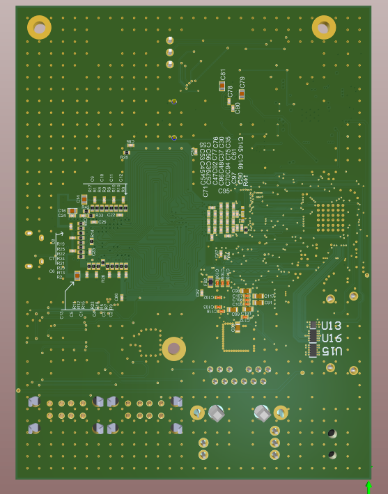

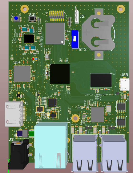

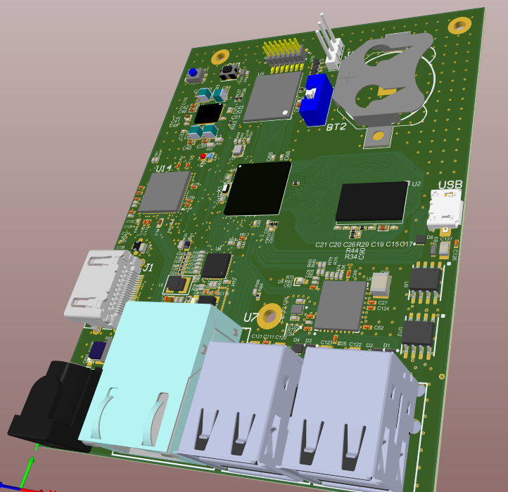

I have build a board of STM32MP151AAC3 processor. It has almost everything, except audio output and DSI Display. STM32MP151 series does not support DSI.

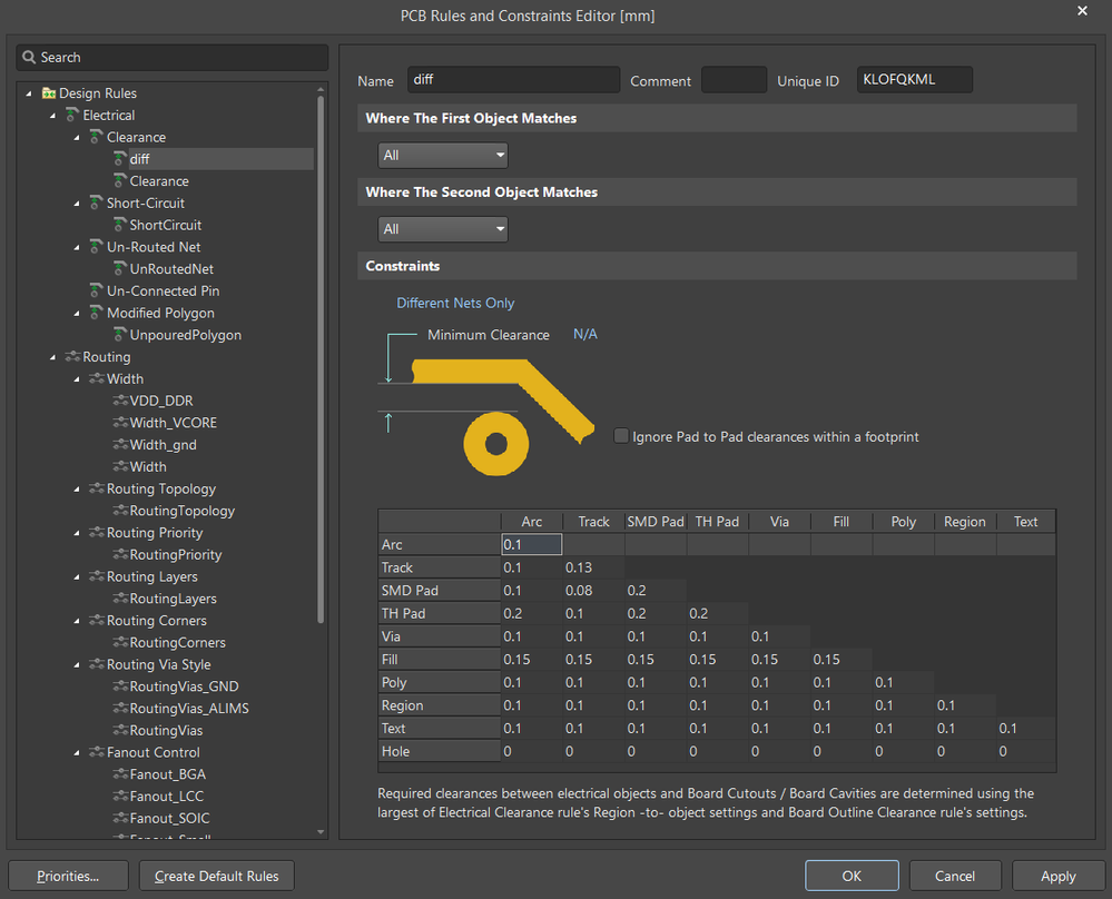

Anyway! I used the included Design Rules from that CAD file .
The Design Rules are narrow and tight, so not even JLCPCB can produce this board.
Question:
Which manufacturer can produce this board if the design rules looks like this?

Thank you. I found out that JLCPCB can produce this board. They approved my design even if I have a minimum clearance of 0.08mm.

even though this isn't the most suitable place to ask, you can try Hi-Tech corp if you need EU production.
