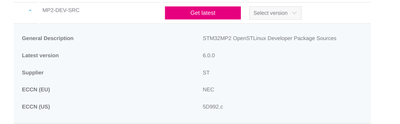

Hello @LiamChen ,
The sources are the one provided at this link here:
The device trees are present under Linux sources, at this place: <Linux_sources>/arch/arm64/boot/dts/st
Kind regards,
Erwan.
