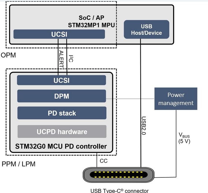

Currently, I'm using X-CUBE-UCSI and came across some information in the user manual regarding the UCSI Operating Policy Manager (OPM) functionality in STM32MP1 series microprocessors. I was wondering if anyone could point me in the right direction to find open resources or documentation related to this topic. Any help would be greatly appreciated.

2023-06-07 2:13 AM
Hi PatrickF (ST Employee) :
Thank you for your response.
Regarding the x-cube-ucsi and UCSI specification documents you mentioned, I designed my device based on these two documents. However, after I finished designing it, I'm not sure if it complies with the standards. I don't have an OPM to test it.
