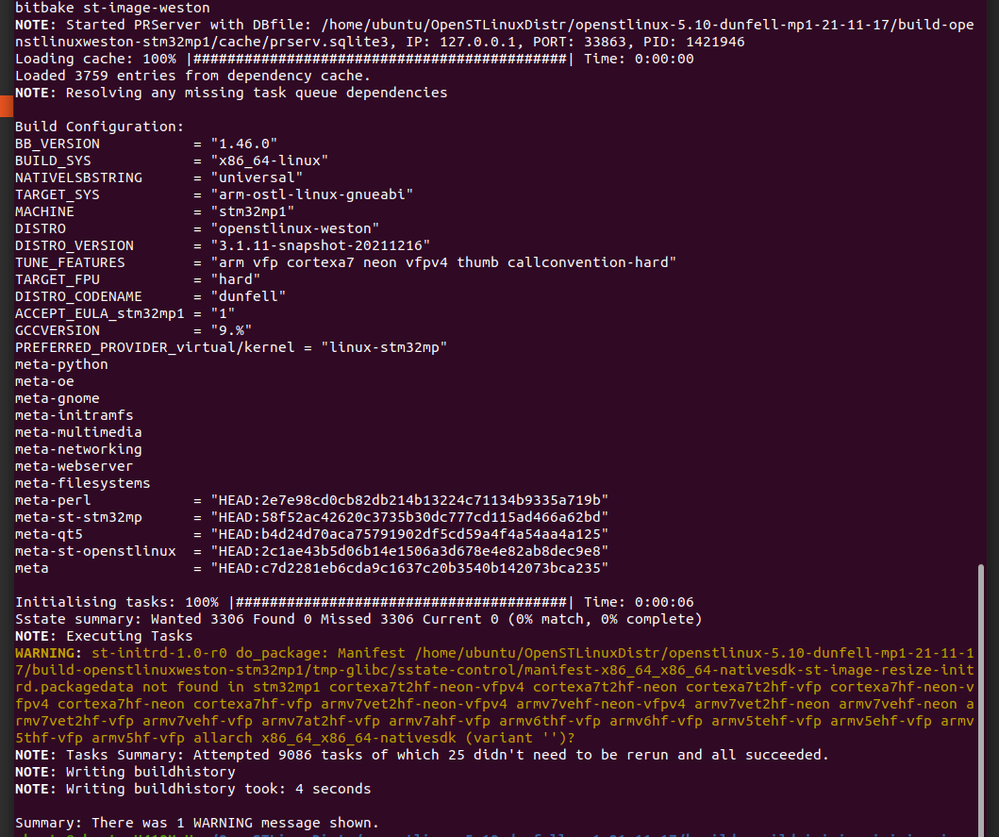

When I build the Open ST Linux distribution, I get the following warning:
WARNING: st-initrd-1.0-r0 do_package: Manifest /home/ubuntu/OpenSTLinuxDistr/openstlinux-5.10-dunfell-mp1-21-11-17/build-openstlinuxweston-stm32mp1/tmp-glibc/sstate-control/manifest-x86_64_x86_64-nativesdk-st-image-resize-initrd.packagedata not found in stm32mp1 cortexa7t2hf-neon-vfpv4 cortexa7t2hf-neon cortexa7t2hf-vfp cortexa7hf-neon-vfpv4 cortexa7hf-neon cortexa7hf-vfp armv7vet2hf-neon-vfpv4 armv7vehf-neon-vfpv4 armv7vet2hf-neon armv7vehf-neon armv7vet2hf-vfp armv7vehf-vfp armv7at2hf-vfp armv7ahf-vfp armv6thf-vfp armv6hf-vfp armv5tehf-vfp armv5ehf-vfp armv5thf-vfp armv5hf-vfp allarch x86_64_x86_64-nativesdk (variant '')?
A little clarification: I'm not adding my machine. It's standart machine. The distribution is loaded into the board and everything works, but I would like to get rid of this warning so that everything is clean. What could it be?

... we are using a recipe to put an image into a package. As a consequence, yocto is not able to know what binary type this refers to.

The build is being completed and everything is working fine, but I would like everything to be perfect.
It's happen on a fresh evironment
