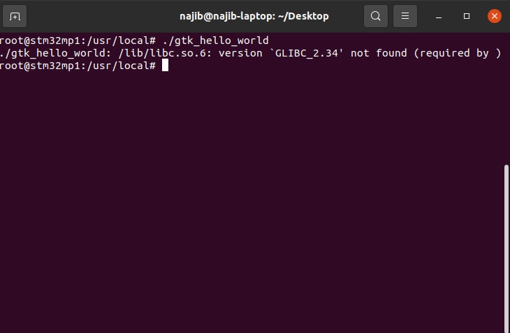

I am trying to apply the hello world example from stm32MP1 workshop. everything works fine for me. However, when I try to run the application inside stm32mp1 it shows me this message. version `GLIBC_2.34' not found.
I tried to install newer version of GLIBC but without any suncess.
could you please tell what to do here.

Sounds like you are not sourcing the right SDK for your OpenSTLinux version.
What is your original setup (DV version / OpenSTLinux package)?

Hi @OlivierK I downloaded wrong SDK for my OpenSTlinux after I download the right one, everything works fine.
thanks for your response.
