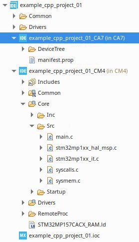

When we create a new project, it seems the IDE doesn't create any ready to compile main.cpp files for the A7 processor like for the M4. See this screenshot:
For the M4, the project compiles with the template main.c just fine. But for the A7, nothing is there.

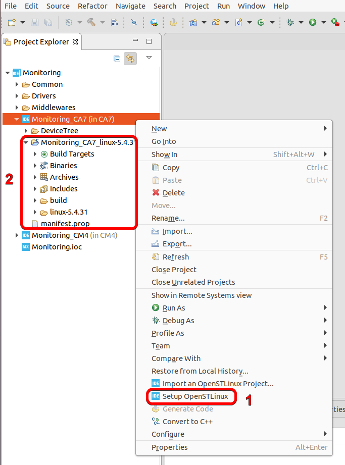

I'm stuck here too... Just a little bit further, i managed to get OpenSTLinux source generated.
1) Right click CA7 project, then click Setup OpenSTLinux
2) Linux sources is now available in CA7 project folder and compile well.
See screenshot:
But here i don't know what to do...
It looks like there is a source folder in build folder, trying to add some file in there but how to compile and execute it?
Does somebody know what to do next?

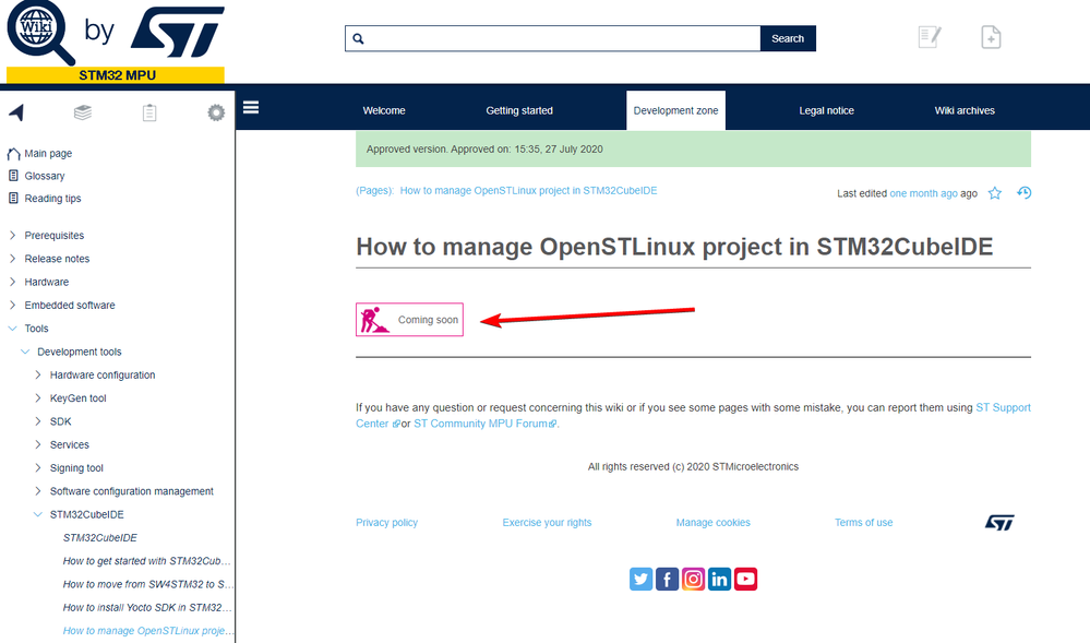

NOTE: The documentation page on How to manage OpenSTLinux project in STM32CubeIDE is under construction a this moment...:loudly_crying_face:
How_to_manage_OpenSTLinux_project_in_STM32CubeIDE

We are also working to publish How_to_manage_OpenSTLinux_project_in_STM32CubeIDE ASAP.
I will keep you posted in coming days.

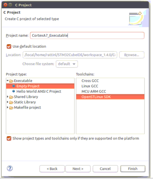

4 - Create a new STM32 A7 project
Open wizard for creating a new C Project : File -> New -> Project .. C project
In first wizard window choose OpenSTLinux SDK
Then Next & Finish

coming back to the initial post here. So when generating a new Project in CubeIDE (File>New...>STM32 Project) there are two projects generated, one for CM4 and one for CA7 (like shown in the initial screenshot). I expected, that it is possible to also integrate user space applications into the CA7 project here. Generating separate projects seems a little bit strange.
If this is not possible. What is the purpose of the CA7 project then?
Thanks
Klaas
2020-12-17 5:29 AM
Hi @Community member ,
CA7 is there to host OpenSTLinux projects ( TF-A, Uboot, Kernel) .
Hosting of user space app will come in next CubeIDE release.
In the meantime we offer this possibility to play with separate projects.
