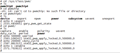

My board use TIM2_CH1 pwm to drive a led.
dts configure as:
but the led can not light on.use these command
byw: I use gpio test led hardware is ok

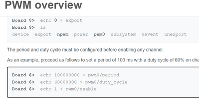

2024-09-06 1:32 AM
Hello @guansonghuang,
Verify that the PWM is exported correctly, you should see pwm0 listed using
ls /sys/class/pwm/pwmchip0
Also, try using an oscilloscope or logic analyzer to verify that the PWM signal is being generated on the correct pin (PF13)
2024-09-06 1:50 AM - edited 2024-09-06 1:59 AM
hi @Sarra.S
I use oscilloscope vefify no pwm out on PF13;
but
1、if change pwm channel1 to PA5.that is ok
2、Enable all 4 pwm out,all other 3 pwm output correctlly excpt for PF13
2024-09-08 7:08 PM
I verify TIM2_CH1 bare metal using PF13. it is the same result as linux not working.
So I assume that PF13 can not be assigened to TIM2_CH1.
please help to double check this. thank you
