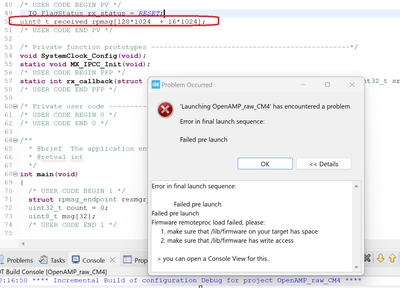

Hi PatrickF,
The problem I am facing is "Failed pre launch" as picture below, when the buffer is start on SRAM2 and end is on SRAM3. But if I make buffer smaller like 100KB (stay only on SRAM2) or 32KB (moved and stay only on SRAM3) then the program runs fine.
