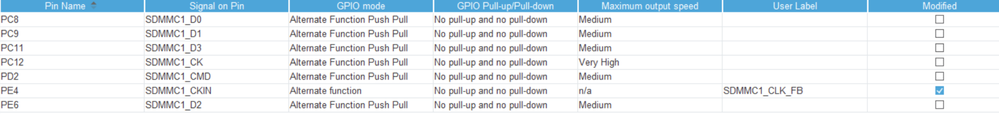

Our pins are configured as follows:
The medium speed setting for the data lines is the default value for CuebMX, but we tested already with higher speeds without success.

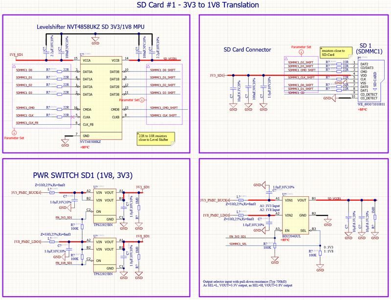

Regarding our Hardware:
We are using the NXP NVT4858 (https://www.nxp.com/docs/en/data-sheet/NVT4857UK.pdf) auto direction level shifter which is capable of up to 208MHz. The IO Voltage of the MPU is 1V8 and we are using the recommendations from your AN, we have added some 22R resistor in series to reduce ringing. At the beginning we start up the card at 3.3V and we switch to 1V8 IO Voltage for the datalanes during the mode transition. One difference is that we do not use a dedicated pull-down at the CLK_IN path.
Schematic:
Can you elaborate the problems with auto dir level shifters and what are the recommendations for the corresponding pull-ups?

2026-02-24 4:33 AM
as there is only one VDD rail on STM32MP15, I assume you have whole GPIOs at 1.8V.
Did you manage to set both the OTP (PRODUCT_BELOW_2V5) and HSLVEN_SDMMC ?
Worth to look at signals and timings to double check potential issues wrt STM32MP15 SDMMC timings and SD-Card timings (need to probe signals on both sides of the level translators).
Beware of using "very high speed" config as this could lead to overshoot/undershoot (i.e. ringing glitches). Recommendation for DDR50 is "medium speed" for all SDMMC signals.

we double-checked everything you mentioned on our side, but unfortunately could not fix the problem.
Can you elaborate the problems with auto dir level shifters and what are the recommendations for the corresponding pull-ups? We are not totally sure here with our setup.
