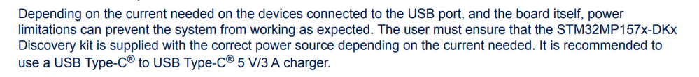

I think , the user manual states it very clear :
You killed one board ? or both ?
Depends, where you did buy them, you could try...
telling something like : " it worked fine one week, then suddenly no more. With same setup, so i think, it was a some chip defective. "
-- Is up to you. You know, you killed it, because not reading the manual in detail. So...you could try, if you think, that's ok.

Ok, just (i would try... :) ) .
And use a power supply , that only (!) can do 5V , 3A . As written in manual.
NOT guessing, it should be do this or that...
And i admit, using the USB-C is in some way seductive , to think, it works like an I-Phone and has high power SMPS inside. But think, this is not a product for the mass market, its for engineers and developers, so the producer can expect, they read, what it can do and what is not allowed.

The STM32MP157F-DK2 is working without issue with any USB Type-C charger which are USB certified.
As per USB-C and Power Delivery standard
The STM32MP157F-DK2 has no power delivery interface, so it is not possible to request something else than default 5V. That's the case of many USB-C powered products.
On STM32MP157F-DK2, the CC lines are only used to check that the charger pull-ups are defining 3A capability according to USB standard.
The STM32MP157F-DK2 has only ESD protection and no overvoltage protection on 5V input.
Your board could be defective, so you could ask for a replacement where you purchase it.
But I suspect the STPMIC1 burn is more related to a short circuit on its external components (usually inductors) which is quite easy with a development board (e.g. probe slip or metal stuff touching the board).
Ultimately, you could also try to replace the STPMIC1A (but need some experience in soldering and adequate tools)
