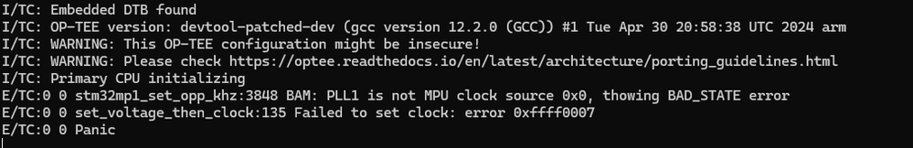

I'm having a challenge moving changes from our Developer Package to our Distribution package. We've modified device trees using CubeMX for our board and have all the changes for TF-A, optee, u-boot and the kernel working in the Developer Package. Now when I take those changes and port them into the distribution package and build with bitbake it is giving me the following error.

E/TC:0 0 set_voltage_then_clock:134 Failed to set clock
E/TC:0 0 Panic
At first I thought it was an issue with op-tee, but once I added some debug statements and it seems like it is related to MPU clock source.
So I shifted gears and have been looking into TF-A. When I replaced my Distribution Package TF-A with the one from the Developer Package, it worked!
So there is some difference between the Developer Package TF-A and Distribution Package TF-A. But the only change I made was to copy the device tree changes from Developer Package to the Distribution Package. Any help would be appreciated.

Hello @badi95,
First of all, I would recommand to use devtool to have an idea about the real content of tf-a built through Distribution Package, and compare it with the version you successfully built through Developper Package: devtool modify command will apply patches from all tf-a-stm32mp recipies to to show what will be really compiled.
The second point is that error comes from OP-TEE : did you apply your OP-TEE patches from Developper Package to Distribution Package ?
BR,
Christophe
