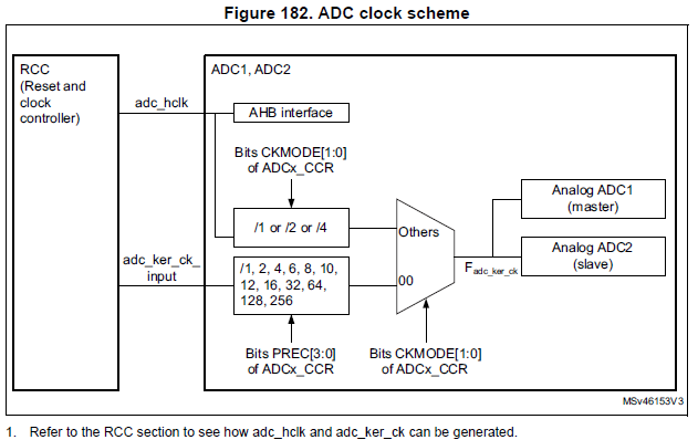

2020-09-22 2:16 AM
Please check if your other platform settings are fulfilling the ADC characteristics of datasheet, especially ADC maximum operating frequency of 20MHz (or 36MHz with BOOST=1).
