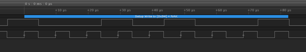

when setting audio via I2C1, I always got NACK on the bus. I have checked AD0=0 , and guess it is the audio codec not ready, how can I resolve this issue?
AUDIO_I2C_ADDRESS= 0x94
void AUDIO_IO_Init(void)
GPIO_InitTypeDef GPIO_InitStruct;
uint8_t Value, ret;
/* Enable Reset GPIO Clock */
AUDIO_RESET_GPIO_CLK_ENABLE();
/* Audio reset pin configuration */
GPIO_InitStruct.Pin = AUDIO_RESET_PIN;
GPIO_InitStruct.Speed = GPIO_SPEED_FREQ_HIGH;
GPIO_InitStruct.Pull = GPIO_PULLUP;//GPIO_NOPULL;
HAL_GPIO_Init(AUDIO_RESET_GPIO, &GPIO_InitStruct);
//OK
/* I2C bus init */
I2C1_Init();
/* Power off the codec */
CODEC_AUDIO_POWER_OFF();
ret = HAL_GPIO_ReadPin(GPIOG, GPIO_PIN_9);
printf("ret1= %d\n",ret);
/* wait until power supplies are stable */
HAL_Delay(10);
/* Power on the codec */
CODEC_AUDIO_POWER_ON();
printf("ret2= %d\n",ret);
// if(HAL_I2C_IsDeviceReady(&I2c1Handle, AUDIO_I2C_ADDRESS, 3, 3000)!=HAL_OK){
// printf("device not ready!\n\n");
/* Set the device in standby mode */
Value = AUDIO_IO_Read(AUDIO_I2C_ADDRESS, 0x02);
AUDIO_IO_Write(AUDIO_I2C_ADDRESS, 0x02, (Value | 0x01));
/* Set all power down bits to 1 */
AUDIO_IO_Write(AUDIO_I2C_ADDRESS, 0x02, 0x7F);
Value = AUDIO_IO_Read(AUDIO_I2C_ADDRESS, 0x03);
AUDIO_IO_Write(AUDIO_I2C_ADDRESS, 0x03, (Value | 0x0E));
}Thanks
