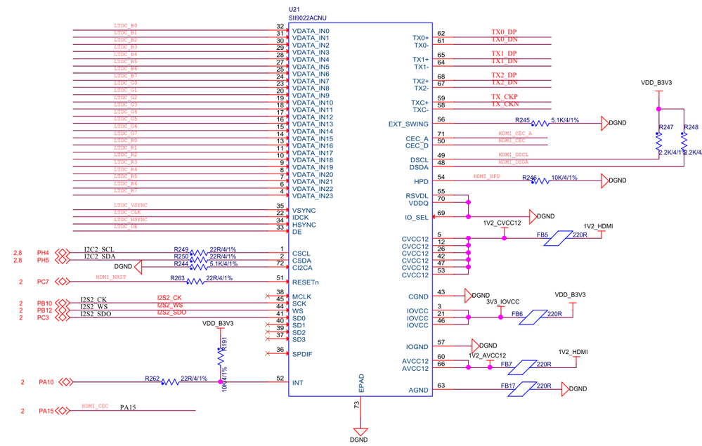

2019-12-06 11:35 PM
I used the i2c4 for sii9022 chip,but it always busy and don't response for hdmi plug in.

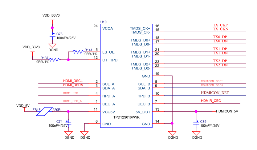

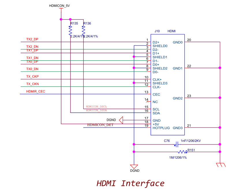

What is the phenomenon of your board now?hdmi no picture?
2020-04-13 8:59 PM
Direct use of hdmi to connect the display, with hdmi to VGA is not. Test dk1 with hdmi to VGA and display
2020-04-13 9:04 PM
Can you post the hdmi circuit diagram?
2020-04-13 9:14 PM
2020-04-13 9:18 PM
It seems that this esd chip has a bug, you can try another hdmi display and try it, the esd I used for the first time also has problems

1.Replace your board hdmi esd.
2.Replace your hdmi display or cable.:)
