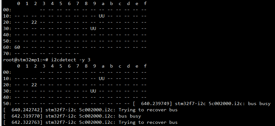

I used the i2c4 for sii9022 chip,but it always busy and don't response for hdmi plug in.

I2C bus busy is usually a bus stuck to 0V, e.g. wrong Hw connection or missing power supplies on one of the I2C slave device on the bus (devices are not always "fail-safe" on their I2C pins)
2019-12-09 2:29 AM
No, it actually works, only to detect the bus reusable by I2C4 will time out

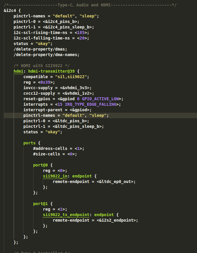

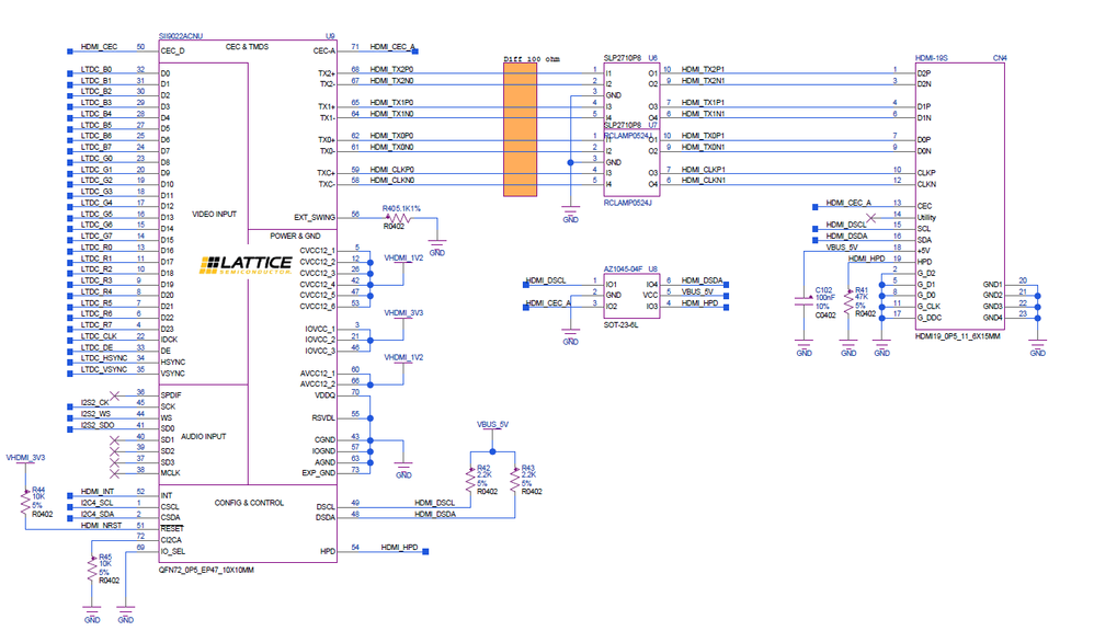

and my i2c4 dts and sch,can you help me,i spend three days but no result...:loudly_crying_face: :loudly_crying_face: :loudly_crying_face:

From HW point if view, I just see that CI2CA pull-down should be 4.7k whereas you have 10k. Not sure it will be the issue, but deserve to align with Si9022 datasheet value.
For SW or DT settings, I cannot help much.

My dts is ok?

Using another esd chip or set pull up res to dscl and dsda:|
