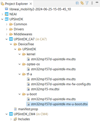

2024-08-01 1:55 AM - edited 2024-08-01 2:00 AM
Thank you Erwan for the solution.
If I understood it well I need to get the right DTSI file for 157c-dk2 and replace with the 157d-dk1 file generated in STM32CubeIDE.
As seen below my 157d - dk1 project has one .dtsi and multiple dts files which i need to replace with 157c -dk2.
I found the stm32mp157c-dk2.dts file here, optee_os/core/arch/arm/dts/stm32mp157c-dk2.dts at master · OP-TEE/optee_os (github.com) which includes the files you mentioned.
Can you please confirm if replacing this file under Device Tree will solve my problem or share any tutorial for further steps.

2024-08-01 7:53 AM
@mpeton ,
In the first lines of your DTS files, I guess that you will find some DTSI inclusion, mentioning revision D of the chip. You will have to replace it with revision C dtsi files. I just talk about the include line.
DTSI files are present in each SW component such as Kernel, TF-A ... You do not have to create it yourself.
