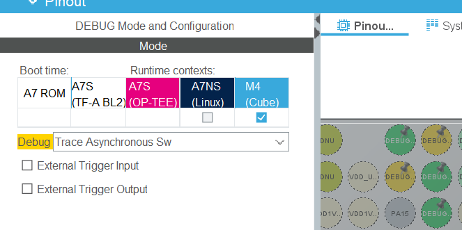

I have configure the Software Debug pins.

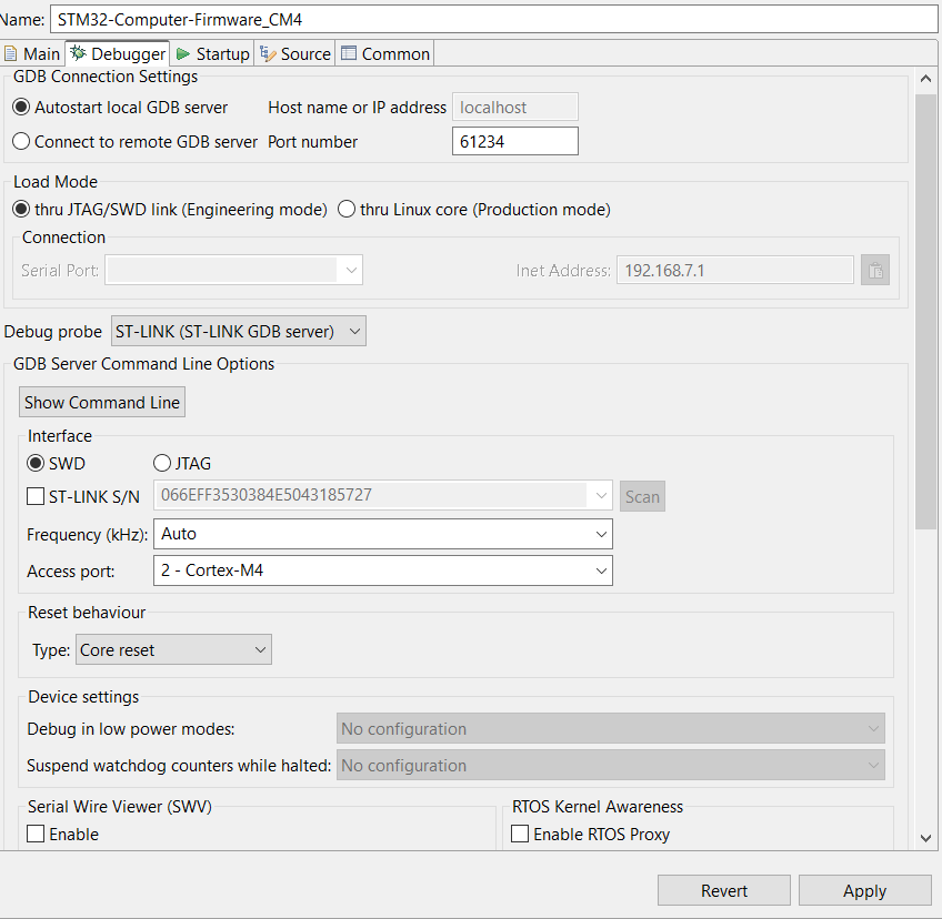

And the debug settings.

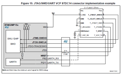

- STLINK is only for debug purpose (so should connect to at least SWD pins SWDIO and SWCLK and GND/VDD, you did not mention those ones)
- To use ST-Link to debug Cortex-M4 FW, you must be either
- in production mode (i.e. Linux up and running from flash and M4 FW loaded thru USB SSH by CubeIDE). this is described in https://wiki.st.com/stm32mpu/wiki/Getting_started/STM32MP1_boards/STM32MP157x-EV1/Develop_on_Arm%C2%AE_Cortex%C2%AE-M4/Modify,_rebuild_and_reload_a_firmware
- in development boot (aka engineering boot), using BOOT[2:0] = 0b100
See https://wiki.st.com/stm32mpu/wiki/STM32CubeIDE#Arm-C2-AE_Cortex-C2-AE-M_debug_on_STM32_MPU_device
