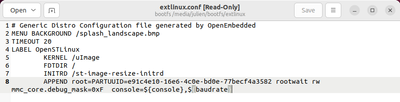

2026-01-14 4:03 AM
Hello
Ive got these message.
you should check a file "extlinux.conf"in /boot or (boot.scr.cmd file)
this file contain : APPEND root=/dev/mmcblk2p6 rootwait rw console=ttySTM0,115200 (example)
if u have a custom board, with someting else on mmc0/1/2 interface (like wifi module), the mmcXX number will shift, and this line reflects no more the target sdcard. you should modify it in order to boot on the parition containning the rootfs.
You should post entire boot log, and explain what you have on mmc interface (sd card/emmc/wifi)
Ive done this a long time ago, maybe no more in use.
good luck
2026-01-14 4:24 AM
2026-01-14 4:43 AM
OK,
the partuuid should corresond to the uuid find in your uboot.
Uuid is a bit unreadable for us, human-trying-to-understand-linux-boot, and mmcblk speaks to me.
root=/dev/mmcblk0p10 rootwait rw console=ttySTM0,115200
root=/dev/mmcblk1p10 rootwait rw console=ttySTM0,115200
The 0/1 in bold reflects the mmc id. 10 the partition id (my rootfs)
Regarding your boot cmd log, the uuid :xxx3582 should be something like mmcblk0p9 or 1p9, worth a try.
