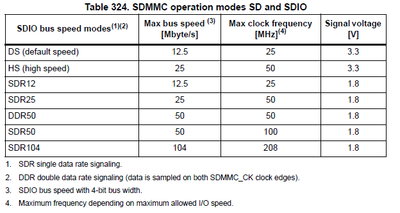

But in this case. I have tried to read the SD Card from MP2 and it's working. But only for the first microseconds.
First the MP2 reads the SD Card. Then the clock signal turns from square wave to incredible fast sine wave.
What I think is the BootROM ask the SD card what typ of SD card it is. Then the SD card introduce itself as UHS-I and the MP2 turn up the speed.
The problem is that my pull up is 3.3V from LDO2. I need to tell the MP2 or the SD card to talk in lower speed. Is that possible?
Or if I already know the speed of my SD UHS-I card. Can I have 1.8V as the initial pull up?

So, you mean that the MP257 is reading the DT?
No, in my TF-a DT, i haven't remove the UHS-I speed. I'm planning to do it.
So it's possible to run UHS-I SD card in slow mode e.g fixed VDDIO_SDCARD = 3.3V?
If yes, well. That must be the answer of this question.

SD-Card always start @3.3V 400kHz, then Host get Card capabilities (voltage, frequencies) to decide to change that later (BootROM keep 3.3V but go to 16MHz after very first card query).
I don't know if it is TF-A or uBoot which speed up to UHS-I (while going to 1.8V for IOs, but Card supply is always 3.3V).
Regards.
