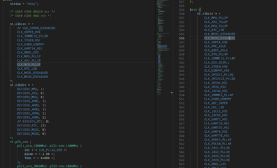

I found that DTS generated with CubeMX set CLK_CKPER_DISABLED for OPP-TEE and TF-A instead of CLK_CKPER_HSE in DK boards while it's the same processor and almost all same peripherals although I only enabled UART4 and USB. After the change it became 24MHz, Don't know why CubeMX disabled PERI. MX also set the RTC clock divider to 0 while for DK1 boards it is 23.

no matter what it did not fix my UART4 clock 151 issue. There is a big difference in clock configuration between DTS generated for a custom board from MX compared to the DTS from ST's own boards. Perhaps ST tuned the DT's for the boards and for a custom board it make it very difficult to understand where a problem could be
