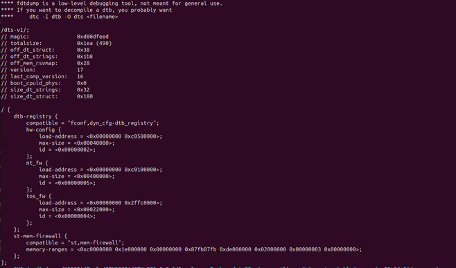

[Note: the NOTICE: DEBUG messages in below logs were added to the source code of TF-A]
The TF-A DT was compiled with option for SYSRAM with resulting dtb fw-config

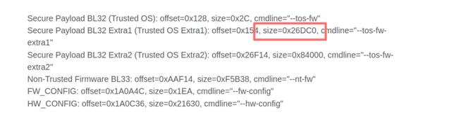

OP-TEE was compiled for SYSRAM and and enabled with pager as can be seen in the contents FIP file:

The OP-TEE generated header file optee-header_v2.bin has the load address for FW_CONFIG (image ID 1) set to 0x2FFC0000, that is the same address that OPTEE tries to load loading Image ID #8 (extra 1) , also the boot log below. Changed the starting address in the OPTEE , conf.mk file to 0x2FFC0200 to avoid a conflict. (shown in the picture below). The optee-header_v2.bin has the size set to 0x26dc0 which is the size of BL32 Extra 1 (ID 8) this isis too large to load in SRAM and created an BL2 load error as above.
After changing the size in the OP-TEE .mk file to to 0x1000 the OPTEE build still set it to 0x26EC0 in the header.:
It seems the OPTEE build ignored the config.mk file setting

The next attempt to load ID 8 (BL32 extra 1) was to manually changing the header file to size of 0x1000.
The changed header as follows
This went through a bit more but an “out of bounds" error is raised. See the log below.

1 Why does OPTEE use the same start address for image ID 8 (Extra 1) and for ID 1 (FWCONFIG) ? Is this correct ? If we had not changed the base address in the conf.mk to 0x2ffc000200 it would start to overwrite FWCONFIG data at 0x2ffc0000 with ID8 BL32, OP-TEE extra 1, data
2. Why does OPTEE set a larger size in the header for BL32 extra 1 than available in SRAM for OT-TEE ?
3. and why does OPTEE ignore the CFG_TSZR_RAM size setting t(to reduce the size for SYSRAM) in the conf.mk file ?
