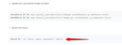

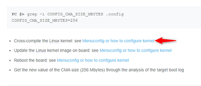

From this link, I came until this step:
And in the link that i pointed, which is:
I followed the instructions, copied uImage and rebooted board like below:
However, my Linux kernel does not start, ST Logo appears and goes, and it continues like this.
Here is my logs:
