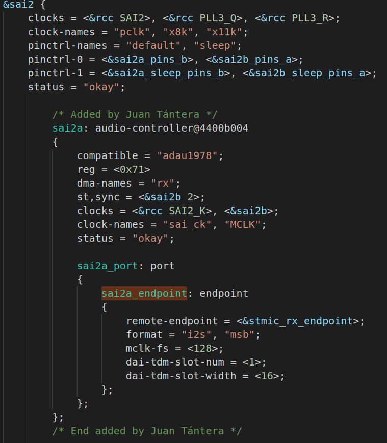

I have very little experience with handling Device Tree and drivers and my problem is that I am trying to connect an STEVAL-STWINMAV1 to the I2S pins of the STM32MP157C, including the I2C port to control it, but I am having serious problems with being able to make it work with the modifications that I do in the "Device Tree".
By default in this I2S port comes the configuration to connect a TLV320AIC3007 from Texas Instruments, I am commenting on the code that configures it and trying to get it to take the ADAU1978 drivers, which I think are compiled in the OpenSTLinux image.

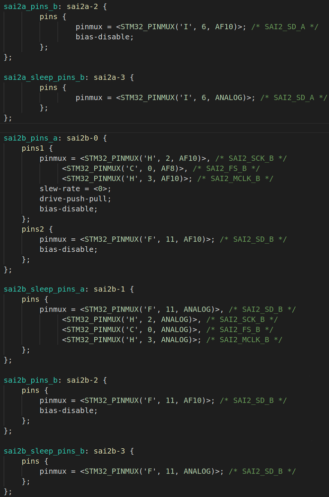

I attach the portion of code that I am editing in the ".dtsi" file and just to corroborate the portion of code in which Phytec configures the pins in their respective ".dtsi" file
The pinout configuration,
I hope someone can guide me to the solution because it is really giving me big headaches.

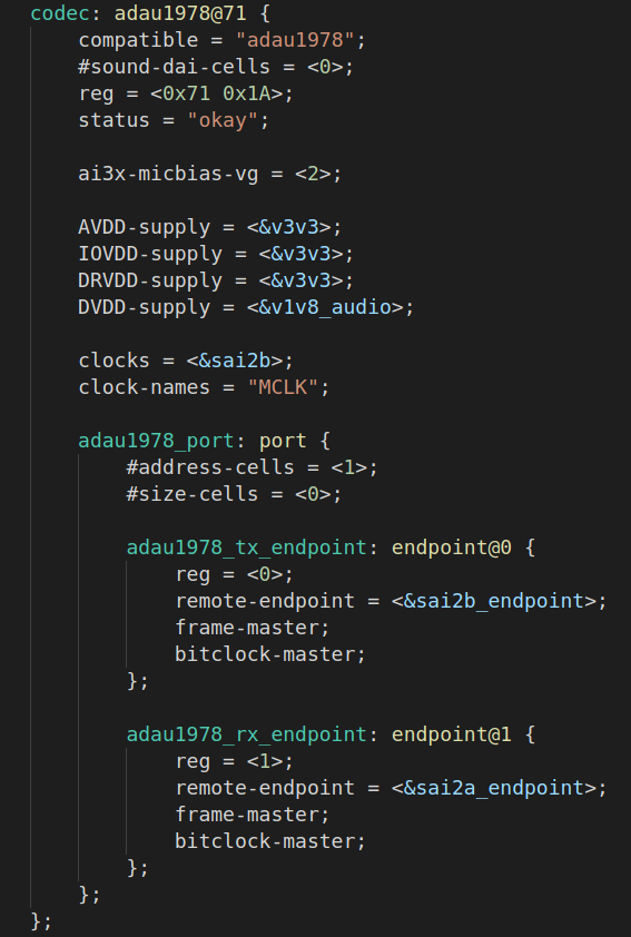

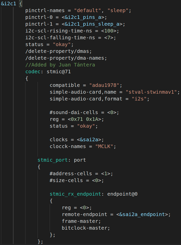

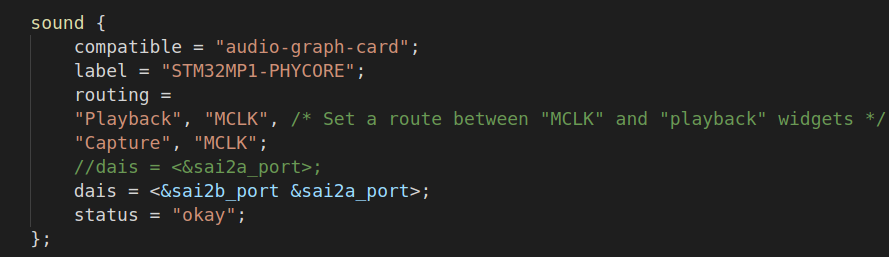

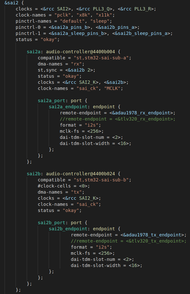

Here is the new code,
Sound
I2C
SAI
Do you see something wrong?
