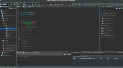

2025-01-11 12:09 AM
If you have made an IDE-project, it should look like this :
"no active editor that provides an outline" = something is missing, to let the IDE know, what to do.
