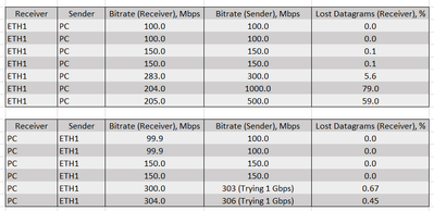

my aim is to achieve a reliable receiving UDP speed with stm32mp13 while sending a payload of 150 mbit/s.
I did performance tests of 1 gigabit Ethernet using a MYD-YF13X development board and iperf3.
Here are some of my results:
19% packet drop rate at 150 mbit/s is, for my purpose, unacceptable.
I think the problem is related to either the MPU or the YT8521SH Ethernet PHY.
But I doubt it is the second one, so I would focus on the MPU itself.
It seems to me that the MPU is not fast enough to achieve a sensible >100 mbit/s receiving speed.

2024-05-27 1:23 AM
Thanks for clarification.
I think your results are reflecting the MP13 single-cpu platform capabilities (UDP is always much less optimized in both HW and SW than TCP).
Industrial use cases (which are the major target of the two Ethernet ports of MP13) are most of the time only using 100Mbit/s.
If you need more performances with single gigabit Ethernet, please look to the STM32MP15. For dual Gigabit Ethernet, the STM32MP25 will be much better.

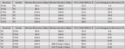

2024-05-27 12:55 AM
Hello @PatrickF
The description of my results might have been ambiguous, so I am providing the updated version.
The receiving drop rate is not satisfying. 19% is too much while sending only a 150 Mbps.
Sending the udp data is also a problem. While trying to send 1 Gbps, only around 310 Mbps is being transferred.

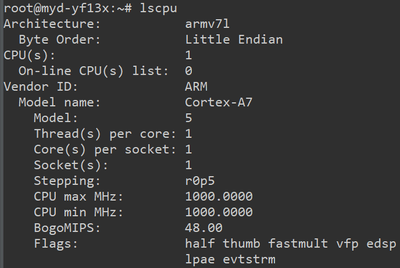

-CPU flavor and frequency
Yes, it is running on 1 GHz, but I do not think the frequency is the source of the slow perforemance.

It occurred to me that I was not connecting the board to the pc with a gigabit ethernet cable.
And after changing the cable, the results are much better.
After this step my requirements are satisfied. The networking performance is still questionable, especially when working with two ethernet interfaces at once.

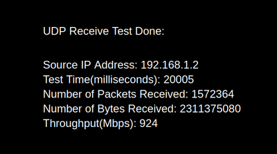

I tested the MYiR developement board with Azure NetXDuo and iperf utility.
I was able to achieve a highly satisfying performance with udp communication.
Best,

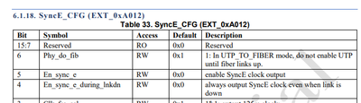

2025-01-11 4:43 AM
Hi @LYUhaha
Yes, the main step is to apply RGMII configuration to your eth interface. You should also adapt the eth driver delivered in the bare-metal package to work with gigabit ethernet. At last be aware of clock signal generated by the YT8521-SH PHY. Make sure it is activated before ethernet initialization, as I good remember, I had to activate it by setting the 5th bit of
The solution worked in my case.
Best
