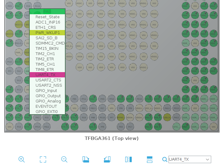

if I use STM32CubeMX seems impossible to use UART4_TX on PA0,8
The key question is: Is it possible to change the hard coded UART4 settings with TX on GPIO G11 for the crash console, in plat/st/stm32mp1/stm32mp1_def.h ?

You should un-select 'Boot ROM' for the UART4 to unrestrict the selection.
if you want to support UART Boot, you are constrained in the choice of UART pins muxing.
You could use another U(S)ART instance (even while keeping UART4 for Linux console) if you want to allow UART boot (USB boot is privileged and sufficient in most cases).
see https://wiki.st.com/stm32mpu/wiki/STM32MP15_ROM_code_overview#UART_Boot and also AN5031
