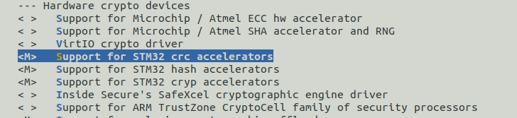

Hello @NPal.2 ,
The configuration that interest you is "CONFIG_CRYPTO_DEV_STM32_CRC".
We can see in your defconfig_file that this configuration is enabled, but as a built-in and not a module:
CONFIG_CRYPTO_DEV_STM32_CRC=y
CONFIG_CRYPTO_DEV_STM32_HASH=y
CONFIG_CRYPTO_DEV_STM32_CRYP=yYou have "Y" instead of "m".
For instance, if you look at the defconfig file from the developer package v3.1, you will see:
CONFIG_CRYPTO_DEV_STM32_CRC=m
CONFIG_CRYPTO_DEV_STM32_HASH=m
CONFIG_CRYPTO_DEV_STM32_CRYP=mTo modify that, you have to use the "make menuconfig" search the 3 configs "CONFIG_CRYPTO_DEV_STM32"
Location:
│ -> Cryptographic API (CRYPTO [=y])
│ -> Hardware crypto devices (CRYPTO_HW [=y])
And press the space key several times until you have switched all of them into modules:
Hope it helps,
Regards,
Kevin

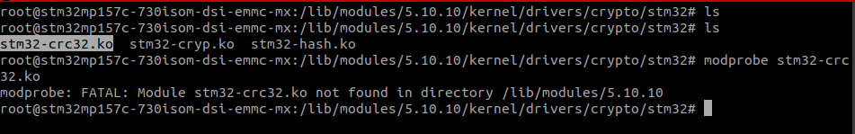

2022-05-02 7:18 AM
@Kevin HUBER Thank you for the quick response. I tried what you suggested. The module does get built and i can it inside the /lib/modules/kernel/drivers/crypto directory. But when i try to perform a modprobe it fails. Any clues why?
2022-05-02 7:21 AM
Never mind. I just checked that it has been loaded as stm32_crc . Looks good now thanks for the support.
