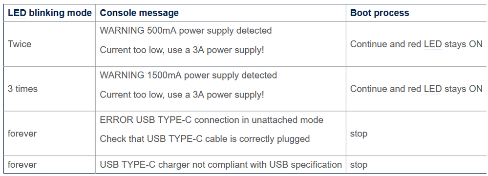

according to your uBoot log, your 5V power supply is not compliant to USB Type-C standard (usually CC lines not or badly connected).
This will stop the Starter Package uBoot with red led blinking.
So your issue is not due to your PC setup.
Solution could be either :
or
First option is straightforward.
Regards.
