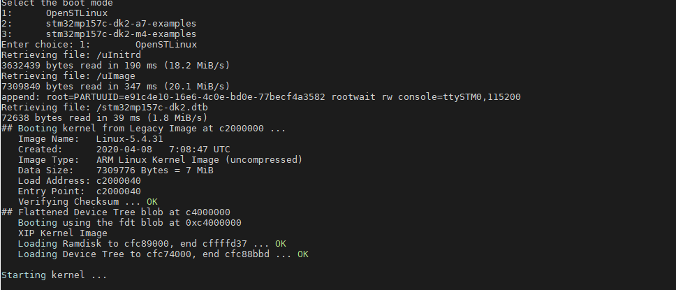

The kernel cannot be started in a loop, as long as I use TF-A+UBOOT to start the kernel

2020-11-08 6:23 PM
I am in the uboot code. Use the configuration file stm32mp15_basic_defconfig. Compile SPL and uboot. Then replace flashing to SD card to start, the following situation will appear
Stuck here, will not boot the kernel
STM32MP157C-DK2
2020-11-09 1:19 AM
Hi @文�?� �?
From ecosystem V2.0, "basic boot" is no longer supported. Uboot SPL can no longer boot the kernel.
Cf https://wiki.st.com/stm32mpu/wiki/STM32MP15_ecosystem_release_note_-_v2.0.0
You have to switch to Trusted boot chain.
Olivier
