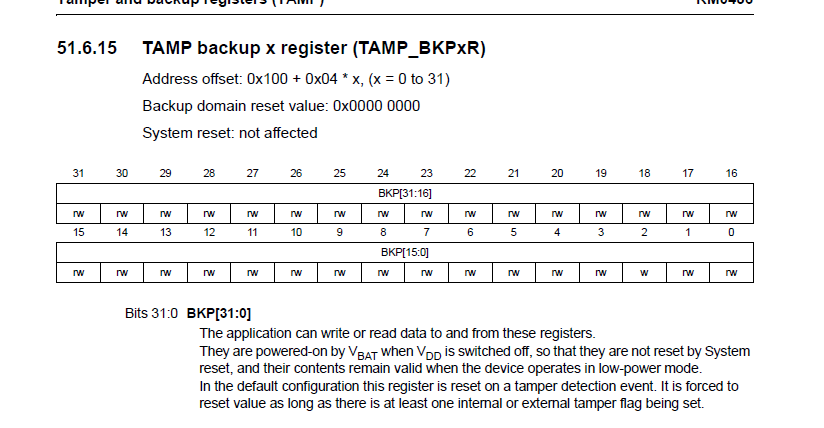

I - Find the address of the TAMP_REG[20] to modify it
https://www.st.com/resource/en/reference_manual/DM00327659.pdf
Page 2532:
Since the base address of the TAMP Register is 0x5C00A000 (page 157):
The address of the backup register TAMP_REG[20] is:
0x5C00A000 + 0x100 + 0x04 * 0x14 = 0x5C00A150

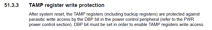

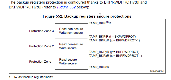

Value at address 0x50000208 (0xb6f17208): 0x113900III - Verify that the register is not protected in write operations
As explained in page 2512 of the reference manual, these registers are protected in write by two registers.
By DBP:
and BKPWDPROT:
I made the test on the stm32mp157C-DK2 with the linux 5.10.61 of the ecosystem v3.1 and by default these registers allows the edit of TAMP_REG 20.

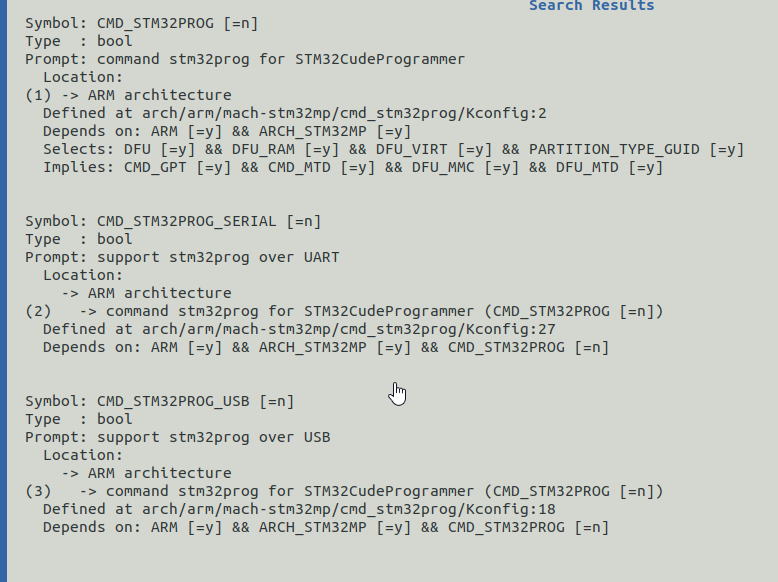

For you second question about u-boot:
In addition I would like to remove support of stm32prog command from our U-boot and also remove the ability to stop u-boot with a key press (security reasons)To remove the command stm32prog of U-Boot, you just have to open the menuconfig:
make menuconfigInside "ARM architecture" -> disable "command stm32prog for STM32CudeProgrammer", the configuration CMD_STM32PROG
