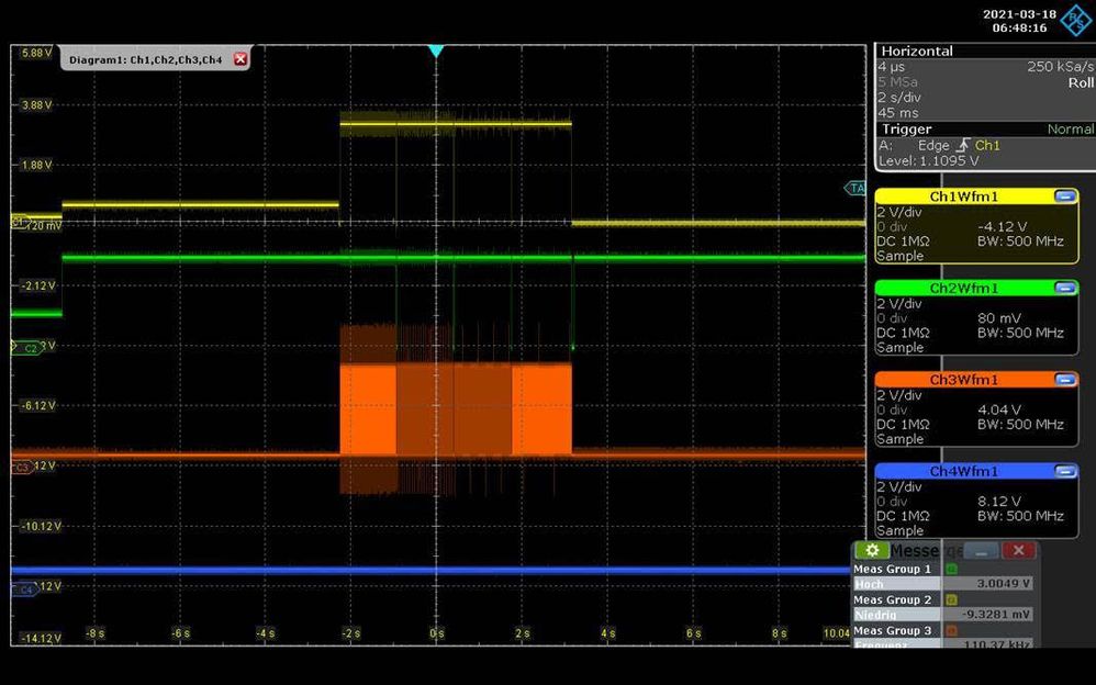

This is the bootup, yellow is the reset GPIO, green is the sdmmc3 D2 pin, which must be high for the wf200 card to go into SDIO mode instead of SPI. Orange is clock.
This happens at boot:

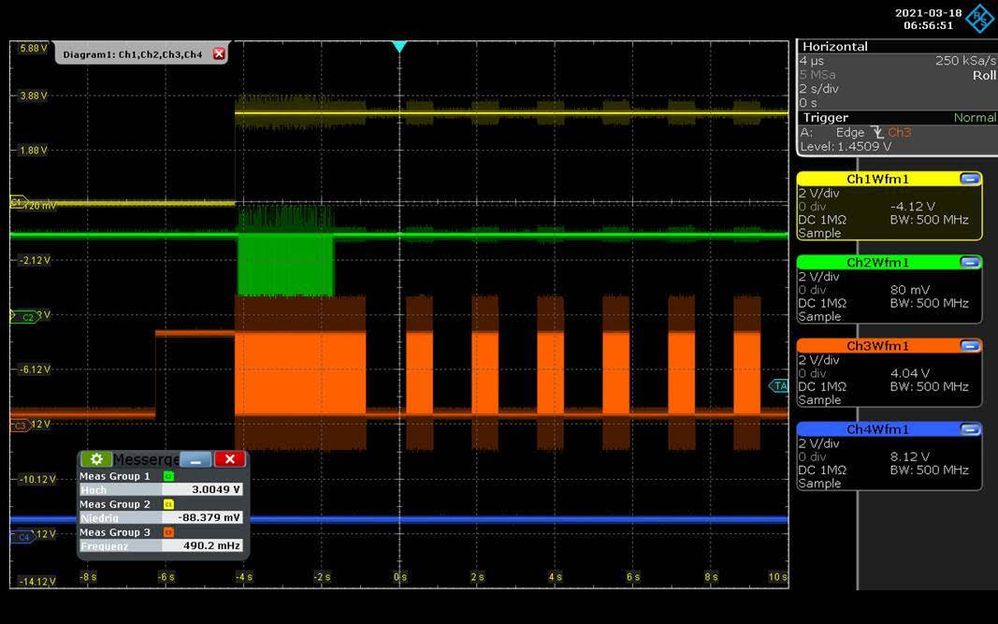

And this is the behavior on manual reset after bootup:
