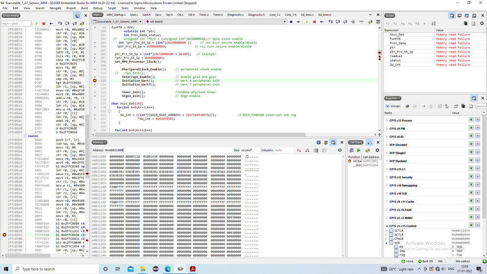

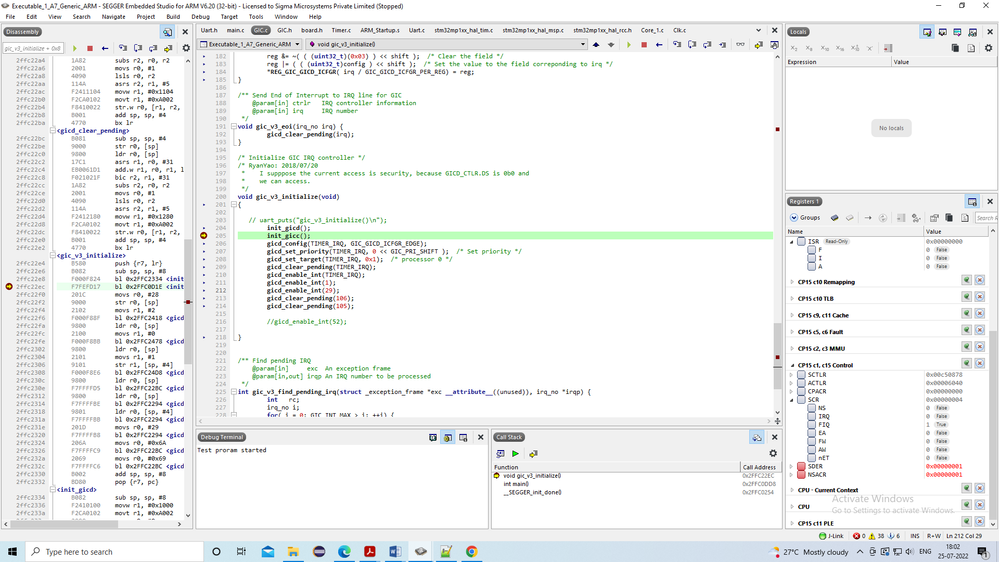

You can see the values for GICD and GICC registers in below attachments.
