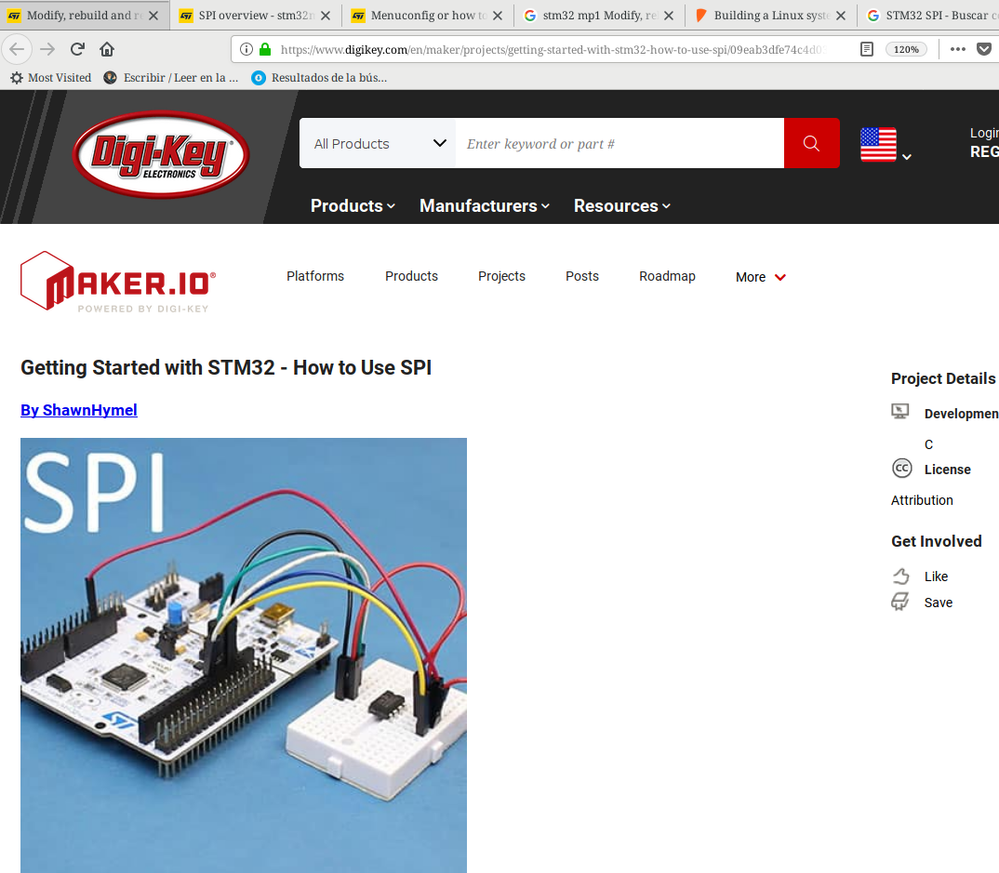

Hola :), I marked exactly this, nothing more than this:
I didn't get errors, at least I didn't see them. I can repeat the process and catch all console output in a text file and upload it if you want.
Thanks for your attention, man.
