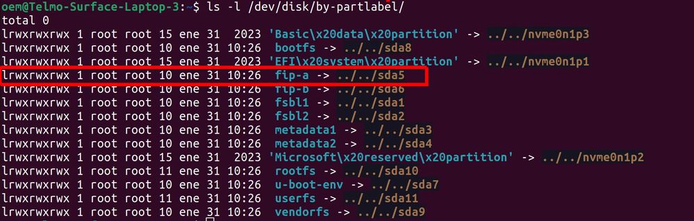

2023-01-31 1:42 AM
Hi @Erwan SZYMANSKI thanks for your reply! :beaming_face_with_smiling_eyes:
I have read and followed the steps of the wiki page (how to cross compile with the distribution package):
I do not know if the ${kernel_addr_r} is not correctly asigned or I have forgotten some step.
Can you help me?
Thanks!
