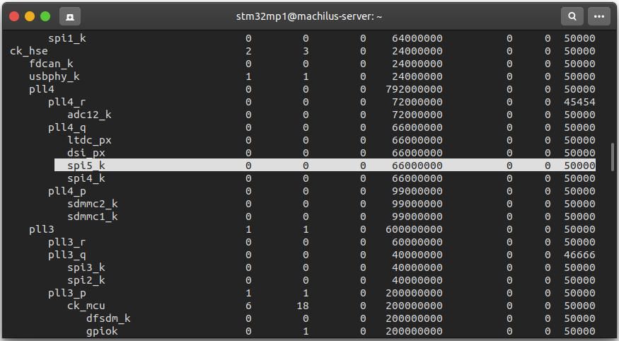

2021-01-25 1:09 AM
Hi PatrickF (ST Employee)
I modified DTS and Firware by referring to the advice.
I looked at it using the command "cat /sys/kernel/debug/clk/clk_summary" and spi5_k was assigned to "pll4_q".

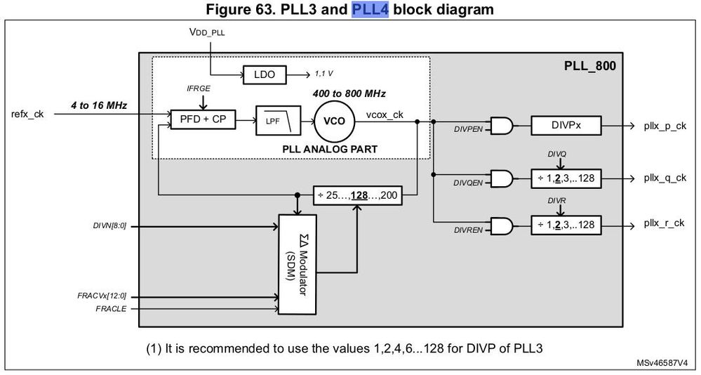

Regarding the linux side of your configuration, I've found your PLL4 freq out of spec. Did you use CubeMx to modify the clock tree? Also for the M4 configuration it would have been much safer to use this tool to prevent setup errors.

2021-02-08 6:10 PM
Hi OlivierK (ST Employee)
In the picture above, you can see that "spi5_k" is set to 66Mhz in "PLL4Q".
Since the clock setting of "PLL4" is as follows, it is normal that 66Mhz appears in "PLL4Q".
/* VCO = 792.0 MHz => P = 99, Q = 66, R = 72 */
pll4: st,pll@3 {
compatible = "st,stm32mp1-pll";
reg = <3>;
cfg = < 5 197 7 11 10 PQR(1,1,1) >;
However, if i set the Baudrate of SPI5 of M4 firmware to "LL_SPI_BAUDRATEPRESCALER_DIV2" in production mode booted with Linux, "SPI5_SCK" will output 2.6Mhz instead of 33Mhz.
