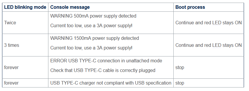

Blue led mean uBoot started, and led6 flashing is probably an USB Type-C compliance issue.
To confirm, could you share the board Console log (available thru ST-Link VCP) ?

Hi @MMarc.11
I was meaning the UART console log using a serial terminal on STLink Virtual Com Port.
This is an example on Linux Ubuntu PC : https://wiki.st.com/stm32mpu/wiki/Getting_started/STM32MP1_boards/STM32MP157x-DK2/Let's_start/Execute_basic_commands#Serial_terminal
On W10 or W11 it is very similar, you could use any terminal application like putty or teraterm or else.
Setup is 115200,n,8,1

I solved the problem, in the logs it showed me the supply current was too low.
