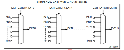

Maybe there is link with the HW limitation which does not allow more than one same 'N' for GPIO interrupt on PxN (x ={A...Z}, and N = {0 to 15} )

I have decompiled the devicetree and tried to look for it, but I cannot find anything about either PA12 or "00002088 (0-0021)"
It seems that it is the hardware limitation that causes it.

I have not yet managed to find out which pin is interfering.
