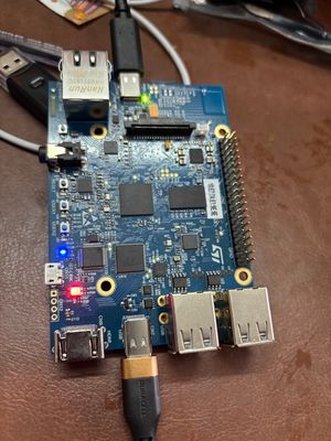

I am trying starting my uboot from micro sd card for my device(STM32MP1157D-DK1 .But I am not getting any serial device connection on my host PC and keep on seeing this Red Led Blinking.
2024-09-25 4:23 AM
I have the STM32MP157C-DK2 and the red LED blinks when the USB is connected near the SD card so that's probably normal. Try another USB-C cable.
2024-09-25 8:20 AM
Hi @priteshtwr
unless you setup something different in your uBoot, the serial console (UART4: TX pin PG11, RX pin PB2) is available on STLINK micro USB connector.
Hope this help.
