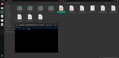

I'm trying modify device tree following this website :STM32MPU Developer Package - stm32mpu
than now Im working on :meta-st-stm32mp/recipes-kernel/linux/linux-stm32mp/README.HOW_TO.txt at mickledore · STMicroelectronics/meta-st-stm32mp · GitHub
My problem is in the kernel source directory (STM32MPU-Ecosystem-v5.1.0/Developer-Package/stm32mp1-openstlinux-6.1-yocto-mickledore-mpu-v24.06.26/sources/arm-ostl-linux-gnueabi/linux-stm32mp-6.1.82-stm32mp-r2-r0$)
I have
0001-v6.1-stm32mp-r2.patch linux-6.1.82.tar.xz
build8 optional-fragment-05-signature.config
optional-fragment-06-nosmp.config optional-fragment-07-efi.config
fragment-03-systemd.config README.HOW_TO.txt
fragment-04-modules.config series
But I dont have Makefile.sdk
I believe
##LINUX_TARNAME## =linux-6.1.82.tar.xz
00*.patch =0001-v6.1-stm32mp-r2.patch
But I there is no makefile.sdk can you help me
