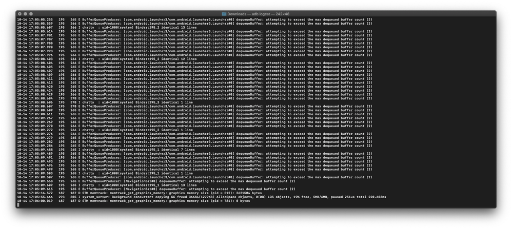

The number of frames per second does not exceed 10. Will there be any performance improvements? Are there any tips?

Hi @Mikalaj Karhin
The AOSP Android porting is delivered as example/enabler with the performances expected for the MP1 (DualCore A7, 1GBytes)
Then, you cannot expect same level of performance than with an OctoCore at 2Ghz + High end GPU.
I remind you the recommended configuration:
Display @480p
DDR32bit 1GBytes
The STM32MP15X-EVAL includes by default a display @720p, which has impacts on performances.
The Andoid AOSP aim to make application in adequation with platform usage target (typically not smartphone UI like application)
