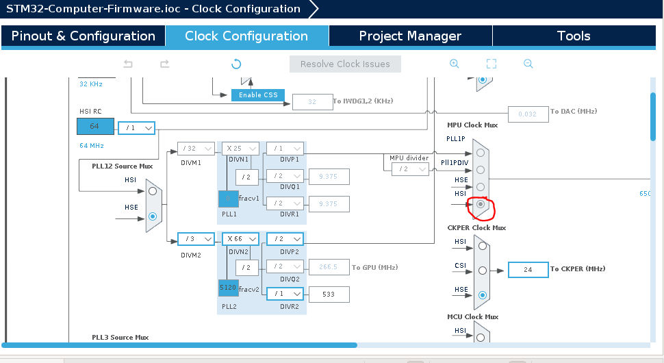

How can I configure so PLL1 is the MPU clock source? It seems that my STM32CubeIDE 1.16.0 did not add the clock source so I did it by myself. Still, the error remains.
st,clksrc=<
CLK_MPU_PLL1P /* <-- Manually added */
CLK_CKPER_DISABLED
CLK_ETH_PLL4P
CLK_SDMMC12_PLL4P
CLK_STGEN_HSE
CLK_SPI2S23_PLL3Q
CLK_I2C46_HSI
CLK_USBO_USBPHY
CLK_CEC_LSE
CLK_I2C12_HSI
CLK_UART24_HSI
CLK_MPU_HSI
CLK_AXI_PLL2P
CLK_MCU_PLL3P
CLK_RTC_LSE
CLK_MCO1_DISABLED
CLK_MCO2_DISABLED
st,clkdiv = <
DIV(DIV_MPU, 1)
DIV(DIV_AXI, 0)
DIV(DIV_MCU, 0)
DIV(DIV_APB1, 1)
DIV(DIV_APB2, 1)
DIV(DIV_APB3, 1)
DIV(DIV_APB4, 1)
DIV(DIV_APB5, 2)
DIV(DIV_RTC, 0)
DIV(DIV_MCO1, 0)
DIV(DIV_MCO2, 0)
>;The STM32-Computer-Firmware is using STM32MP151AAC3 processor. As you can see, the HSI clock is the clock of the MPU and that's the cause of the error.

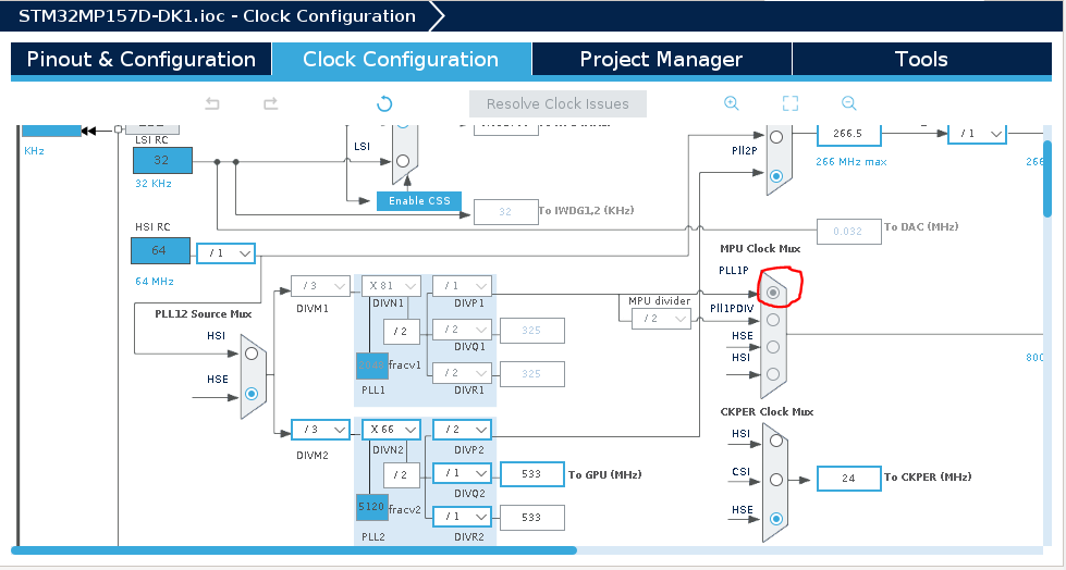

This one is made with default settings when I first created a empty project with STM32MP157D-DK1 board. Here the PLL1 lock is the clock of the MPU.
2024-08-11 12:22 PM - edited 2024-08-11 2:37 PM
Here is the solution: Go to the pin configuration tab in STM32CubeIDE. Then select RCC and change "User defined" from FALSE to TRUE. Then you are allowed to change the MPU clock. Make sure that the output is exactly 650 MHz. Just copy the STM32MP157D-DK1 clock configuration. Done!
