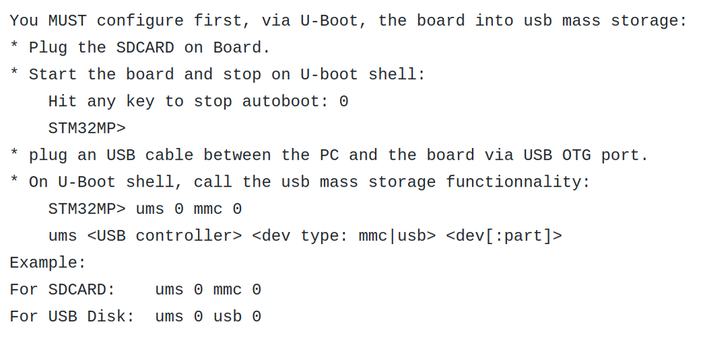

I try this example but have some problem.
I don`t have folder "/media/$USER/bootfs/" and media/$USER/rootfs/lib/modules/
My board complete this step.
But error occurs this command .
/media/sh/bootfs/ is not directory. (*'sh' is my user name)
What is problem? ^^;;

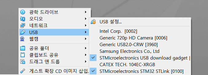

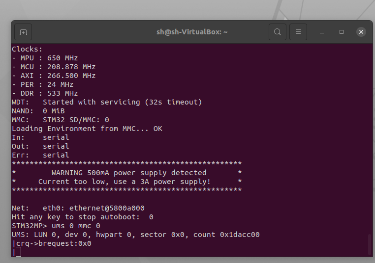

When proceed to :

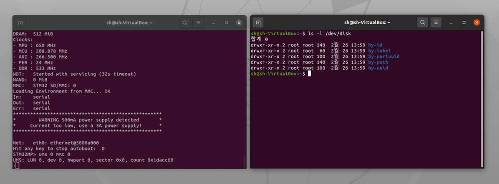

STM32MP > ums 0 mmc 0
A new USB "STMicroelectronics USB Download gadget" should be visible in your Virtual Box. Please check it's not connected windows side.
You should get something like :
PC $> ls -l /dev/disk/by-partlabel/
total 0
lrwxrwxrwx 1 root root 10 Feb 8 08:57 bootfs -> ../../sdb4
lrwxrwxrwx 1 root root 10 Feb 8 08:57 fsbl1 -> ../../sdb1
lrwxrwxrwx 1 root root 10 Feb 8 08:57 fsbl2 -> ../../sdb2
lrwxrwxrwx 1 root root 10 Feb 8 08:57 rootfs -> ../../sdb6
lrwxrwxrwx 1 root root 10 Feb 8 08:57 ssbl -> ../../sdb3
lrwxrwxrwx 1 root root 10 Feb 8 08:57 userfs -> ../../sdb7
lrwxrwxrwx 1 root root 10 Feb 8 08:57 vendorfs -> ../../sdb5
and :

I connected USB in Virtual Box but keyboard is stopped in kernel folder(install_artifact) console.
And at the moments, board is reboot and kernel folder console is available.
So I can`t command ls -l /dev/disk/by-partlabel/ cuz can`t use keyboard.
What is problem? T.T

Hi @Community member ,
I'm afraid this is purely related to your VirtualBox environment for which I can not help much.
Double check and try to get help on some dedicated community.
