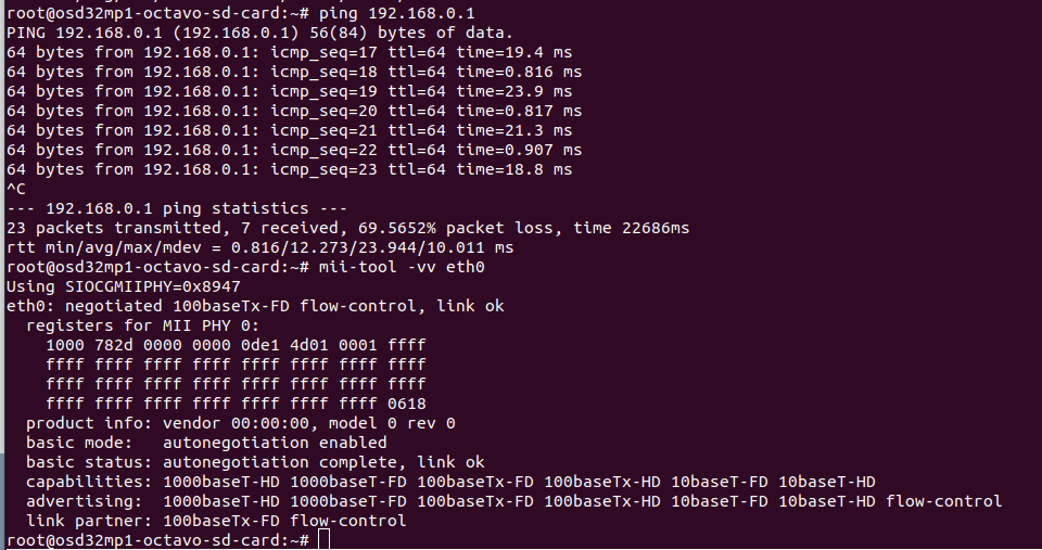

2021-11-16 10:51 AM
I also installed net-tools
and typing
mii-tool -vv eth0
I receive something
So I'm not able to read PHY ID.
From the documentation, I read that ID is 0007.C0D1. This ID is identical to LAN911x.

[ 2.824784] stm32-dwmac 5800a000.ethernet: IRQ eth_lpi not found
[ 2.829640] stm32-dwmac 5800a000.ethernet: PTP uses main clock
[ 2.835410] stm32-dwmac 5800a000.ethernet: no reset control found
[ 2.842036] stm32-dwmac 5800a000.ethernet: User ID: 0x40, Synopsys ID: 0x42
[ 2.848625] stm32-dwmac 5800a000.ethernet: DWMAC4/5
[ 2.853614] stm32-dwmac 5800a000.ethernet: DMA HW capability register supported
[ 2.860968] stm32-dwmac 5800a000.ethernet: RX Checksum Offload Engine supported
[ 2.868399] stm32-dwmac 5800a000.ethernet: TX Checksum insertion supported
[ 2.875361] stm32-dwmac 5800a000.ethernet: Wake-Up On Lan supported
[ 2.881819] stm32-dwmac 5800a000.ethernet: TSO supported
[ 2.887104] stm32-dwmac 5800a000.ethernet: Enable RX Mitigation via HW Watchdog Timer
[ 2.895042] stm32-dwmac 5800a000.ethernet: device MAC address a2:6d:9e:38:f7:a6
[ 2.902415] stm32-dwmac 5800a000.ethernet: Enabled Flow TC (entries=2)
[ 2.909062] stm32-dwmac 5800a000.ethernet: TSO feature enabled
[ 2.914958] stm32-dwmac 5800a000.ethernet: Using 32 bits DMA width
[ 51.958489] using random self ethernet address
[ 51.961564] using random host ethernet address
[ 53.374605] stm32-dwmac 5800a000.ethernet eth0: PHY [stmmac-0:01] driver [SMSC LAN8710/LAN8720] (irq=52)
[ 53.437576] stm32-dwmac 5800a000.ethernet eth0: No Safety Features support found
[ 53.485457] stm32-dwmac 5800a000.ethernet eth0: IEEE 1588-2008 Advanced Timestamp supported
[ 53.500961] stm32-dwmac 5800a000.ethernet eth0: registered PTP clock
[ 53.547373] stm32-dwmac 5800a000.ethernet eth0: configuring for phy/rmii link mode
[ 53.584953] 8021q: adding VLAN 0 to HW filter on device eth0
[ 53.600653] stm32-dwmac 5800a000.ethernet eth0: Adding VLAN ID 0 is not supported

2021-11-19 8:36 AM
Hi MWoło.2 (Community Member)
Just one remark. Is it specific to the LAN9303 to redefine in the mdio node:
clocks = <&rcc ETHCK_K>;
clock-names = "rmii-ref";
Rgds,
Olivier
2021-11-19 2:44 PM
Hi Olivier,
my current DTS looks like following
ðernet0{
pinctrl-names = "default", "sleep";
pinctrl-0 = <ð1_pins_mx>;
pinctrl-1 = <ð1_sleep_pins_mx>;
status = "okay";
phy-mode = "rmii";
max-speed = <100>;
phy-handle = <&phy0>;
st,eth-ref-clk-sel;
clock-names = "stmmaceth",
"eth-ck",
"mac-clk-tx",
"mac-clk-rx",
"ethstp";
clocks = <&rcc ETHMAC>,
<&rcc ETHCK_K>,
<&rcc ETHTX>,
<&rcc ETHRX>,
<&rcc ETHSTP>;
mdio0 {
compatible = "snps,dwmac-mdio";
#address-cells = <1>;
#size-cells = <0>;
phy0: phy@1{
compatible = "ethernet-phy-id0007.C0D1", "ethernet-phy-ieee802.3-ac";
reg = <1>;
reset-gpios = <&gpioa 4 GPIO_ACTIVE_LOW>;
interrupt-parent = <&gpiog>;
interrupts = <12 IRQ_TYPE_EDGE_FALLING>; /* ETH_MDINT# */
reset-delay-us = <10000>;
post-reset-delay-us = <1000>;
switch: switch@0 {
compatible = "smsc,lan9303-mdio";
#size-cells = <0>;
dsa,member = <0 0>;
reg = <0>;
ports {
#size-cells = <0>;
port@0 {
reg = <0>;
label = "cpu";
ethernet = <ðernet0>;
port@1 { /* external port 1 */
reg = <1>;
label = "lan1";
port@2 { /* external port 2 */
reg = <2>;
label = "lan2";
};my log is
[ 2.969615] libphy: stmmac: probed
[ 2.984053] LAN9303_MDIO stmmac-0:00: Found LAN9303 rev. 1
[ 3.249640] LAN9303_MDIO stmmac-0:00: Found LAN9303 rev. 1
[ 3.321255] LAN9303_MDIO stmmac-0:00: Using legacy PHYLIB callbacks. Please migrate to PHYLINK!
[ 3.340418] LAN9303_MDIO stmmac-0:00 lan1 (uninitialized): PHY [dsa-0.0:01] driver [SMSC LAN911x Internal PHY] (irq=POLL)
[ 3.354287] LAN9303_MDIO stmmac-0:00 lan2 (uninitialized): PHY [dsa-0.0:02] driver [SMSC LAN911x Internal PHY] (irq=POLL)
[ 3.367043] LAN9303_MDIO stmmac-0:00: LAN9303 MDIO driver loaded successfully
[ 54.013139] stm32-dwmac 5800a000.ethernet eth0: PHY [stmmac-0:01] driver [SMSC LAN911x Internal PHY] (irq=52)
[ 56.055846] LAN9303_MDIO stmmac-0:00 lan1: configuring for phy/gmii link mode
[ 56.374405] LAN9303_MDIO stmmac-0:00 lan2: configuring for phy/gmii link mode
[ 100.075252] LAN9303_MDIO stmmac-0:00 lan2: Link is Up - 100Mbps/Full - flow control rx/tx
[ 134.085231] LAN9303_MDIO stmmac-0:00 lan1: Link is Up - 100Mbps/Full - flow control rx/tx
[ 168.715032] LAN9303_MDIO stmmac-0:00 lan2: Link is Down
[ 169.435065] LAN9303_MDIO stmmac-0:00 lan1: Link is Down
and everything seems to be work but I have a problem with VLAN filtering
[ 54.130459] 8021q: adding VLAN 0 to HW filter on device eth0
[ 54.130514] stm32-dwmac 5800a000.ethernet eth0: Adding VLAN ID 0 is not supported
[ 100.082137] IPv6: ADDRCONF(NETDEV_CHANGE): lan2: link becomes ready
[ 134.092101] IPv6: ADDRCONF(NETDEV_CHANGE): lan1: link becomes ready
[ 145.520560] stm32-dwmac 5800a000.ethernet eth0: Link is Up - 100Mbps/Full - flow control rx/tx
[ 145.528055] IPv6: ADDRCONF(NETDEV_CHANGE): eth0: link becomes ready
[ 147.737539] net eth0: Dropping packet due to invalid VLAN marker
[ 147.742227] net eth0: Dropping packet due to invalid VLAN marker
[ 147.754183] net eth0: Dropping packet due to invalid VLAN marker
[ 147.758863] net eth0: Dropping packet due to invalid VLAN marker
[ 150.928970] net eth0: Dropping packet due to invalid VLAN marker
[ 150.933682] net eth0: Dropping packet due to invalid VLAN marker
[ 150.939763] net eth0: Dropping packet due to invalid VLAN marker
[ 150.945837] net eth0: Dropping packet due to invalid VLAN marker
[ 151.102514] net eth0: Dropping packet due to invalid VLAN marker
[ 151.107207] net eth0: Dropping packet due to invalid VLAN marker
[ 152.765556] lan9303_rcv: 6 callbacks suppressed
[ 152.768763] net eth0: Dropping packet due to invalid VLAN marker
[ 152.774845] net eth0: Dropping packet due to invalid VLAN marker
[ 152.781109] net eth0: Dropping packet due to invalid VLAN marker
[ 152.787024] net eth0: Dropping packet due to invalid VLAN marker
[ 152.793150] net eth0: Dropping packet due to invalid VLAN marker
[ 152.799229] net eth0: Dropping packet due to invalid VLAN marker
[ 153.417139] net eth0: Dropping packet due to invalid VLAN marker
[ 153.421823] net eth0: Dropping packet due to invalid VLAN marker
[ 153.432334] net eth0: Dropping packet due to invalid VLAN marker
[ 153.437043] net eth0: Dropping packet due to invalid VLAN marker
[ 161.525183] lan9303_rcv: 8 callbacks suppressed
[ 161.528379] net eth0: Dropping packet due to invalid VLAN marker
[ 161.534468] net eth0: Dropping packet due to invalid VLAN marker
[ 161.540766] net eth0: Dropping packet due to invalid VLAN marker
[ 161.546639] net eth0: Dropping packet due to invalid VLAN marker
[ 161.552685] net eth0: Dropping packet due to invalid VLAN marker
[ 161.558848] net eth0: Dropping packet due to invalid VLAN marker
[ 161.564941] net eth0: Dropping packet due to invalid VLAN marker
[ 161.570962] net eth0: Dropping packet due to invalid VLAN marker
[ 164.017030] net eth0: Dropping packet due to invalid VLAN marker
[ 164.021672] net eth0: Dropping packet due to invalid VLAN marker
[ 169.027536] lan9303_rcv: 6 callbacks suppressed
[ 169.030707] net eth0: Dropping packet due to invalid VLAN marker
[ 169.040067] net eth0: Dropping packet due to invalid VLAN marker
[ 175.675825] stm32-dwmac 5800a000.ethernet eth0: Link is Down
Unfortunately, I have no idea what this VLAN means. I read that LAN9303 do not support filtering but how to disable or work around this. guess that for this reason, I have not received an IP address.
Ref.
https://01.org/linuxgraphics/gfx-docs/drm/networking/dsa/lan9303.html
2021-11-20 7:46 AM
VLAN warning removed by disabled options in the Kernel.
2021-11-22 11:34 AM
DSA switch works. For my purpose, I don't need to add a LAN9303 driver. Just LAN911x is sufficient enough. Finally, I understand that this switch works like a daisy chain connection. The conclusion is
ðernet0{
status = "okay";
phy-mode = "rmii";
max-speed = <100>;
st,eth-ref-clk-sel;
"eth-ck",
"mac-clk-tx",
"mac-clk-rx",
"ethstp";
<&rcc ETHCK_K>,
<&rcc ETHTX>,
<&rcc ETHRX>,
<&rcc ETHSTP>;
mdio0 {
#size-cells = <0>;
phy0: phy@0{
compatible = "ethernet-phy-id0007.C0D1";
reg = <0>;
};In rootfs, I just see eth0, which works in DHCP mode. The first LAN I connect to the router and the others to a laptop, for instance. So I'm able to address the board from any devices in the system. Don't connect both LAN1 and LAN2 to the same router.
The part
switch: switch@0 {
#size-cells = <0>;
dsa,member = <0 0>;
reg = <0>;
ports {
#size-cells = <0>;
port@0 {
reg = <0>;
label = "cpu";
reg = <1>;
label = "lan1";
reg = <2>;
label = "lan2";
};It is only needed when you want to filter some packets, make some bridges etc.
That is all. I think this thread/topic can be closed.
Thanks a lot
BR Michal
