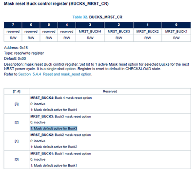

2024-10-28 12:47 AM
please refer to STPMIC1 datasheet mask_reset settings.
bit = 1 mean the NRST activation will not have action on this supply (i.e. no power cycle)
Regards.

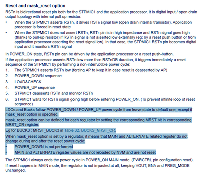

2024-10-10 2:37 AM
you don't give much information on the setup.
If you use STPMIC1, when NRST toggling is detected (i.e. Watchdog or SW reset request), there is a complete power cycle done (unless SW program STPMIC1 at run time to behave differently).
So, in that case, you will see a POR reset reason.
In our starter package SW, we reprogram STPMIC in OpTEE to avoid VDD power cycle, thus allowing to get correct reset reason in the registers (if reset does not occur during boot, before OpTEE is started).
Regards.

2024-10-28 12:47 AM
Regards.
2024-10-28 1:40 AM
Hi @PatrickF
Thanks for the reply, we will test and update you.
