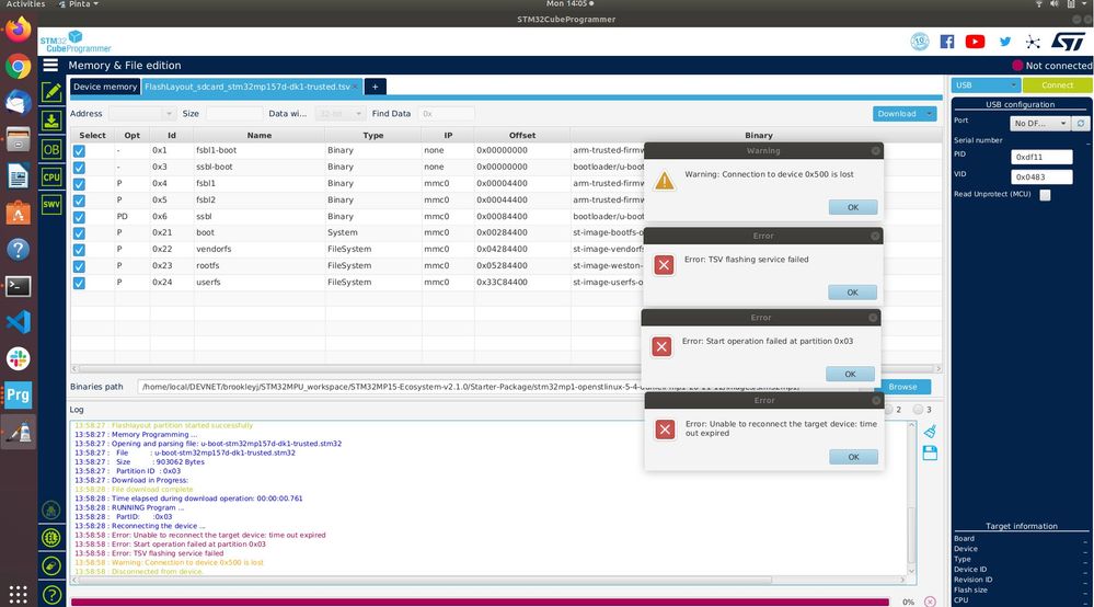

I'm getting familiar with the STM32MP1 tools on a linux laptop and I'm trying to burn the demo to my STM32MP1D-DK1 board. I know most the demos are aimed at the DK2 but it's sold out everywhere and I don't currently need wifi or bluetooth (or an LCD), so this seemed good enough for me.
Anyway, I'm trying to follow the instructions on the STM32MP1 wiki page (
https://wiki.st.com/stm32mpu/wiki/Getting_started/STM32MP1_boards/STM32MP157x-DK2/Let%27s_start/Populate_the_target_and_boot_the_image) and I'm running into an issue when trying to burn the firmware:
Unfortunately, I get the errors above, a red LED (LD5?) starts flashing on and off, a blue LED (LD6?) stays on, and LD4 continues to toggle on and off about every second or so (this was the same prior to burning the firmware as well.
I tried to follow a similar tutorial to burn via a command line (https://wiki.st.com/stm32mpu/wiki/STM32MP15_Discovery_kits_-_Starter_Package#Preparing_the_USB_serial_link_for_flashing) and had a similar issue. Here's what I'm getting:
~/STM32MPU_workspace/STM32MP15-Ecosystem-v2.1.0/Starter-Package/stm32mp1-openstlinux-5-4-dunfell-mp1-20-11-12/images/stm32mp1$ STM32_Programmer_CLI -c port=usb1 -w flashlayout_st-image-weston/trusted/FlashLayout_sdcard_stm32mp157d-dk1-trusted.tsv

Error:
Unable to reconnect the target device: time out expired
Error: Start operation failed at partition 0x03The errors look similar, which makes sense (whatever is an issue with one is likely the issue with another).

Memory Programming ...
Opening and parsing file: u-boot-stm32mp157d-dk1-trusted.stm32
File : u-boot-stm32mp157d-dk1-trusted.stm32
Partition ID : 0x03
Download in Progress:
[==================================================] 100%
File download complete
Time elapsed during download operation: 00:00:00.935
RUNNING Program ...
PartID: :0x03
Reconnecting the device ...
Error:
Error: TSV flashing service failedThere is now a solid blue LED on the board (LD8) and LD6 (I think) is a blinking red light.
It appears that I'm back in the same position I was earlier. Not sure if I missed a step or misunderstood something? What am I missing?
Thanks for your help, Patrick!
