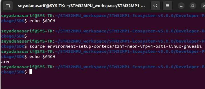

Hello @Ahmed ,
Maybe you didn't source the SDK environment.
To ensure you did, when you enter "echo $ARCH" command it sould return "arm"
Armand

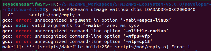

@ArmandG i am also facing the same issue while Build the Linux® kernel source code for the first time. how to rectify this. but i receive correct reply from sdk while i "echo $ARCH" run this commend.
main error
