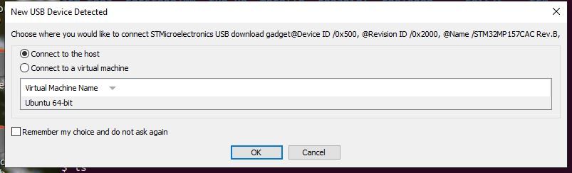

Hello HKim.23 (Community Member)
1- As you are using VMWare and Windows on the same machine, could you make sure the USB ressources are not shared between the 2 OS while using STM32CubeProgrammer.
2- I've just checked the source files of the starter package, tf-a-stm32mp157d-ev1-usb.stm32 is indeed present. Make sure you select the right path in the "Binary Path" and double check the file is present (or download again the starter package https://my.st.com/content/my_st_com/en/products/embedded-software/mcu-mpu-embedded-software/stm32-embedded-software/stm32-mpu-openstlinux-distribution/stm32mp1starter.html

2021-07-20 12:21 AM
OlivierK, Thanks a lot.
Once I succeeded in downloading through Windows.
In order to successfully download in Windows, the bin folder containing STM32_Programmer_CLI is registered as the environment variable PATH.
Then I went to the folder where the Image is and performed the download.
Downloaded normally.

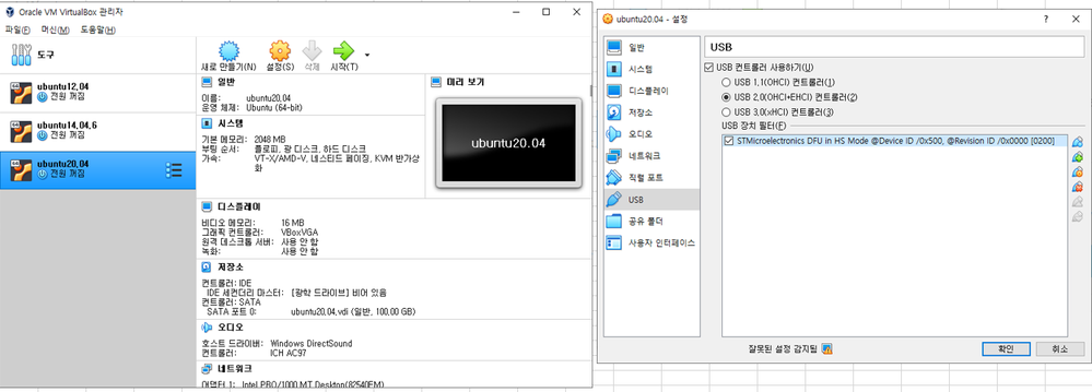

But I still have questions. If you know about this, please reply.
1. When downloading in Windows, the download speed is very slow. Do you have any way to improve this? Now it takes over a minute.
2. If using Vmware, you said "make sure the USB ressources are not shared". Is this possible in Vmware? If you know how to set this up, please guide me.
for reference, to use usb in Vmware linux, I am using as follows.

I confused VMWare and VirtualBox.
I will try what you said.
Thank you for answer.
