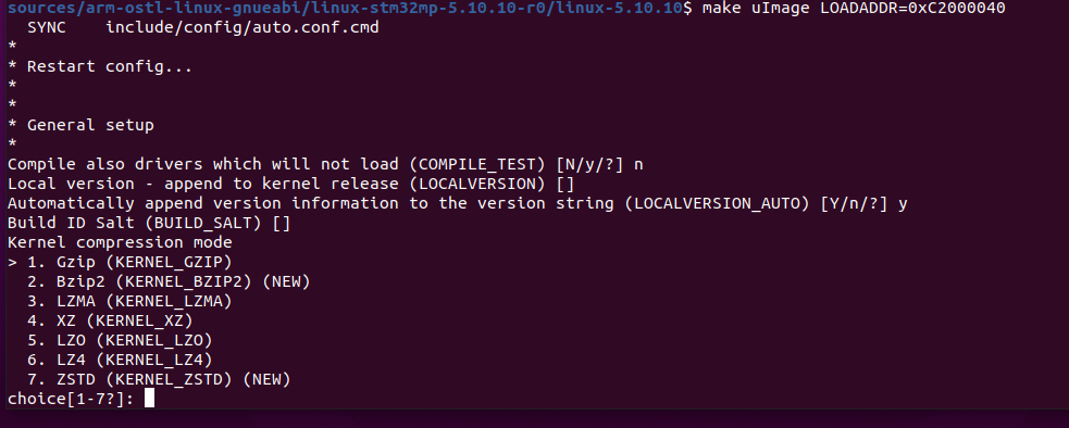

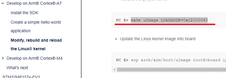

I'm trying to rebuild the kernel as described on the wiki page. When I run make, the wiki shows unexplained choices that eventually result in an error. Is there a possible problem?
(unexpected) following choices appear
Best Regards

Hi @KNaka.6 ,
It seems that the kernel configuration is not correct before launching the compilation : did you followed the instructions in Prepare the Linux® kernel source code chapter ?

2021-07-20 1:15 AM
After reviewing the my Linux environment, the DistributionPackage was successfully created according to the ST wiki.
Thank you
