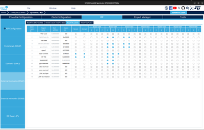

Bad command, the traces are printed in the remoteproc framework. Please use following one:
#echo -n 'file remoteproc*.c +p' > /sys/kernel/debug/dynamic_debug/controlConcerning Cube MX:
you have a "CID filtering" column in RIF. Unchecking the box should disable the filtering.

Here is my view of the DDR page. I do not see the CID filtering column
