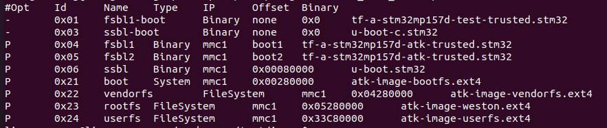

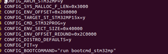

I found that the UBoot env stored at the same address as the bootfs, which caused emMC to fail to start the kernel
Env and Uboot are both at 0x280000 addresses,

And normally CONFIG_ENV_OFFSET is not used for env/mmc.c if "u-boot,mmc-env-partition" is defined in config node of DT
but it can be used as fallback when the partition name is not present in the device tree.
in ST boards, CONFIG_ENV_OFFSET=0X2800000 is used ony for NOR
